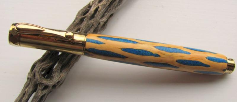

I'm getting ready for the Desert Woodturning RoundUP. One of my demos is making pens from alternative materials. I was given two bags of cholla cactus from a good friend from NM at the AAW symposium in Albuquerque two years ago. I took one piece last nite and here is the result. The voids were filled with powdered azurite and thin CA. This will not be the last of these for me. Comments welcome: good, bad, or indifferent.

Greg: Thanks for the comment. I wanted to do a one barrel pen and the sierra wasn't the right size and the Zen was the only other I had on hand. Actually, I wish it were the zen because I like the magnetic top. It is actually one of the other Zen types with the screw on cap which I do not like because the caps do like to come off. Anyway, thanks for commenting...I appreciate it.
Louie: Thanks also for the comments. No pressure pot. I just placed the azurite powdered stone in the voids, packed it in and dropped a couple of drops of thin CA on top. I did this for each void. Filling the voids took longer than turning the pen. The stone is quite hard and rough on the tools. I actually used the Easy Wood Tool easy rougher with the r4 tip. Sanded and finished with CA. My next one will be cast with colored PR and then I will use the pressure pot. Watch for the next one.

Don, Nice job! I'm not a big fan of that plating however, it is a nice match. Did you have to drill out the inside at all? Someone cast a piece of that for me once using black PR and all I did was turn it round between centers and then drill my hole, then turn the rest of the way down. If you didnt drill through it, then that must have been a painstaking task filling all of the voids?!

Thanks Seamus. I don't like the kit either, but I do like the Zen with the magnetic cap. That (not liking the stretch) is one reason I chose this kit, just in case it didn't work out.
I found a piece of cactus that was a good fit for the tube but was just a bit too small. I did drill it out, insert the tube and drizzle a little thin CA. Then I individually filled each void...one at a time... If I cast, I will cast with the tube inserted and plugged and hope the PR fills the voids.
