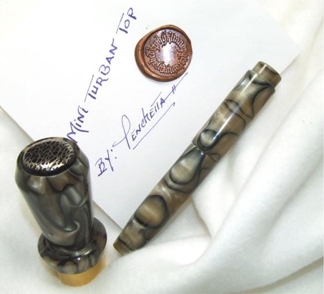

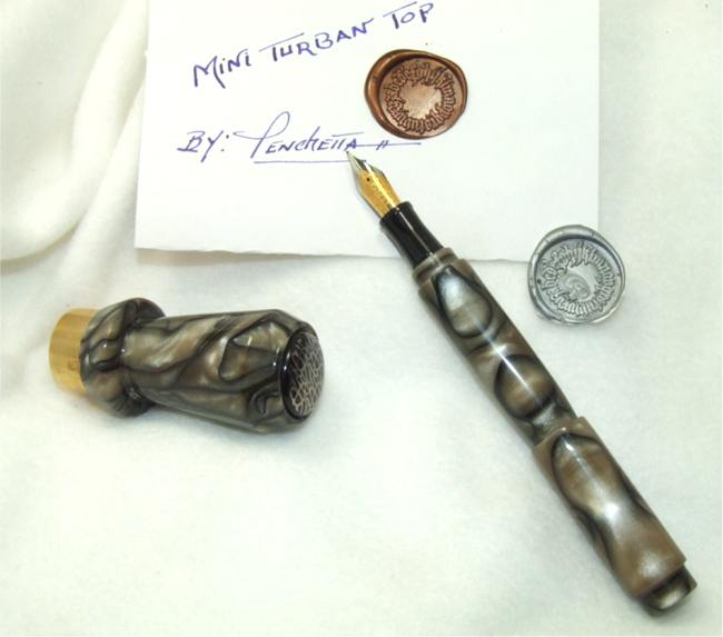

Here is another of my mini turban top pens from the early 1920's,
The only pen part in this pen, is an El Grande nib. No other pen
parts to be found. Brea AA resin from BB. Weighing in at only 24 grams with cap and ink. A nice little pant pocket FP.
The wax seal stamp was made to match the pen, cabachon by Dawn, you know.....the one that made Ed4copies famous :D
Thanks for looking, as allways, comments welcome. :)

Originally posted by vick
<br /> could you give any info on how you improved the friction cap?
Nothing that new, just refining the choice of drill bits used and easier to make tubeless with the use of the new pin chuck BB is selling , runs very true. Still it comes down to hand fitting the parts.

It looks to be El Grande or a Ligero did you tap the body to accept the nib feeds threads or turn down the coupler and counter sink it in the body?
I am not familiar with the Ligero kit if that is what you used so I guess the coupler may not need modification.

Originally posted by DCBluesman
<br />IS the nib holder also friction fit?
Nope, I tapped the inside of the pen barrel to hold the nib.
It is an El Grande nib, threads are 10x1.00 metric.

PenWorks
Aug 18, 2004
5,186
Scottsdale, AZ
Originally posted by gerryr
<br /> How long is it closed?
5" closed - 6" posted
Ed, your bad. [:D] Actually it gets opened about 25 times a day,
it is going through the Penchetta quality control torture test. [:)]
