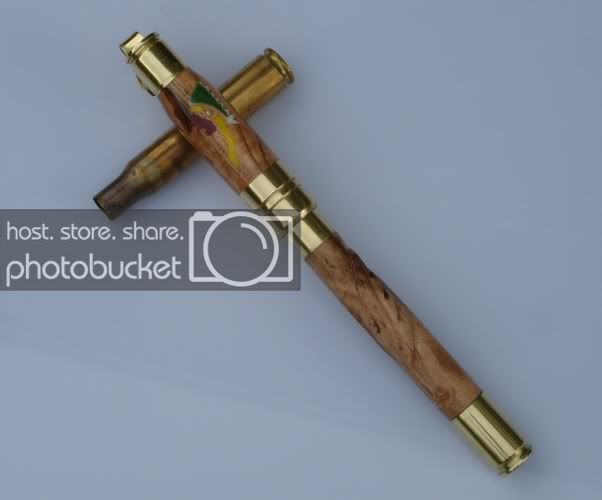

Ok, I'll be the first to flex some muscles here. Raise the bar a bit, I think anyhow. I present to you.... " Apache"
Scrolled Apache Chief in Cherry Burl, and a carved feather in the pen section. It uses more than one cartridge end section, and one 3/4 long front section. The threads are welded on. One of the new nib sections from Lou, the smaller of the two choices he is offering now. And I built my own clip to represent an Indian arrow. Special thanks to the Captain for helping me with my threading situation.

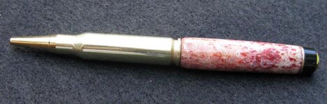

I'm just posting this to enter for now. It is just a basic cartridge to get me in and I will do something a little different for my entry pen. I think all of the pens I have seen so far look pretty good, the trash talk isn't something I'm going to get into. You all know where I'm sending my pens after the contest.

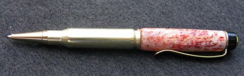

What's the red Neil? is it punky antler that was cast in resin?
Jeff, this stuff was the softest antler I had ever seen. It was almost 2" in diameter and was falling apart when I touched it. The red is in there naturally, bit the antler is stabilized with Ultraseal and then some CA to fill in the bigger gaps.

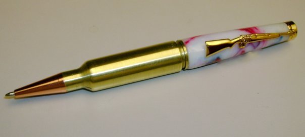

Here's my first. The blue didnt show up as much as I wanted in the red/white/blue top. It's made from a .300 wsm with a rifle clip for good measure.

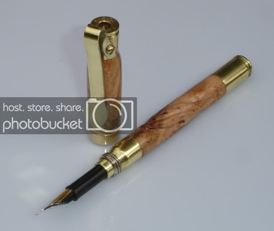

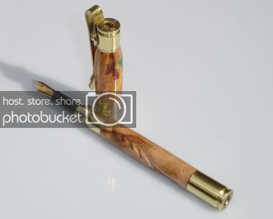

It's too late for me to use my lathe and finish the cap tonight, so here is the main bit. It's a fully functional pen anyway and so I think it qualifies already:confused:
I'll do the cap tomorrow.
This is my first casing pen so don't be too cruel:biggrin:
Hey Jeff, you aren't going to change the rules and swap either of yours for something decent are you???:biggrin:
EDIT: OK, Cap done:tongue:

It looks really good Steve. Did you have to do any hand sanding in any spots to flush it with the top of the bullet, or did you luck into a perfectly round bullet? I like your cap transition. Not having the equipment, I started with brass pipe fittings. I bored one out and trimmed it to fit the neck and that worked out great. But then I had to try and use the nut for the cap section and that did not work out so good! That's why I had to go outside and get a bit of help. There's just not enough wall thickness on a brass plumbing nut and I couldn't get it to spin round, so I just kept removing too much on one side, revealing the threads on one side. I cursed a lot! I tried mounting just a nut, and I tried it with a threaded rod inside..either way I couldn't get it.
And no..I won't change any rules. I suggested what I wanted to do, Cav laid it out. What it is is what it is, I'm good with that. As challenging as this was for me, I quite enjoyed it. I like challenging myself. Working with casings is very challenging for most of us. That's one of the biggest reasons I wanted to have the challenge. People should build and enter, regardless whether their pen is just a bullet and a top section or they can go beyond. Since I know several will be watching, well like Neil, you don't have to have a smack down. If you post a pen and someone smacks on it..just ignore it and don't smack back then people will not continue about you..even though it's really all just in fun anyhow guys/gals.

Jeff, Ed and Dawn sent me quite a few, but none were as bad as I'd heard about. But to make sure it was round and true where the bullet goes in here's what I did..
As the casing has a bit of a taper to it, I just stuck a layer of tape on the narrow end. Then chucked it snug on the headstock. Sprayed some WD40 and then slowly drove the dead centre on the tailstock into it. Seemed to work fine, but honestly, they weren't too bad to start with.
I'm sure others have noticed this, but I found that even though the outside was tapered, the inside hole seemed parallel all the way down.
I believe that there is actually enough brass there to turn the outside down parallel too if needed.

My FIRST entry is complete and I swapped the previous pic to show the cap:biggrin:
