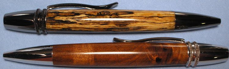

The Bloodwood set and African Blackwood Cigar that I posted earlier was finished this way as well as these 2 Polaris pens. 1st is Spalted Oak with TN hardware. 2nd is Mesquite root from my Wichita Falls trip.
