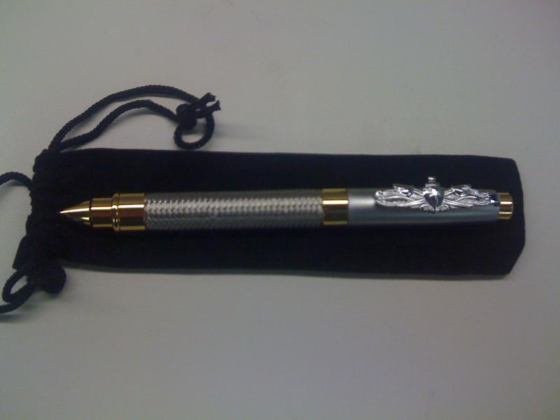

Is this the type your looking for? Its not a kit but its not inexpensive either. I put the clips on this type of pen and some of the ones that I turn. The clips sell good but the braided pen no so much.
