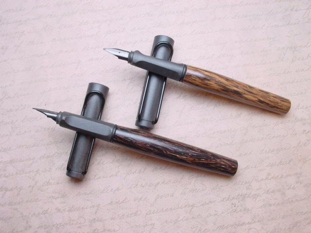

This is something a little different. One of the best pens I sell is a $25.00 Lamy Safari FP. German engineering at its best. I hate to say it, but I write with one everyday, you can't break it, and writes in demand every time. I think one of the reasons the ink always is wet on the nib, is the air tight snap cap they designed. Very simple yet effective. Also this is a one piece front section molded together which is air tight & leak proof.
Anyways, a couple pen barrels made it threw, black palm & spalted yellow birch, two others broke while threading the inside of the wood.
Thanks for looking.

Now that is real cool... it is a shame you can't do the cap also... but I love the idea...
How did you tap the wood for the nib section...

Tom, I used a hand tap to cut the threads. Wood does not take to cutting fine threads to well. I think the next ones I do. I am going to insert some type of poly tubing into the wood pen barrel and thread the tubing, this way I should avoid the pressure and splitting that happened on the other two. I was going to do a cap as well, but I know I would not have been able to duplicate the presise tollerances they have and that's one of the things that keep this pen writing all the time. they way the cap snaps over the front section, and the clip is pretty cool.

I thought the stabilized blanks would be better, so all of them were stabilized. I went by the tap & die chart and had the right size hole drilled...... The thread size is a 10 x .75 metric.
Here is what the original pen looks like, They don't make a black so I thought the charcol was the best color to match with the wood.

Those turned out really neat Anthony! I like the idea of being able to do color, too. Do you think you could remove the clip and basically build a cover for the cap (then put the clip back on)?
Oooo...you know what might be a REALLY cool thing? To make "skins" for these that can be added and taken off like the face plates for cell phones! You could embed a rare earth magnet in the top of the cap and the bottom of the base, and use matching magnets in the ends of the "skins" to keep the "skins" in place.

I like the look Anthony. Do those nibs come out of the front plastic part? Maybe they unscrew from it? Looks like they could be used for other projects as well. I like the clearance under the nib. I'll buy a couple of the kit parts if you can spare some.

Bruce, in the Safari line, you can not just buy a nib. It is just the complete front section that is a molded one piece unit. The only thing you can do, is slide the steel nib off and replace with a different nib.

Anthony, nice work! I have to agree, yours looks much better then the original. Your choice of wood really compliments this pen and gives it a much richer look. So, how much did you raise the price? [:D]

Very nice Anthony!! Did you try tapping before turning, or after? How about putting on a hose clamp before tapping? I've got to try some of those. Really nice.

I tapped after turning. Good idea, I will try before turning, but I was afraid, since the bushing is in the nib end when I turn, that it would screw the threads up. The hose clap is another good idea, because the wood just barely split when I was running the tap in.

Anthony your pens are very nice, you can tapped them before turning if you tapped a male bushing, I explain, when you tapped your blank ( who is female ) try to do a bushing size male tapped ( with hard wood or better still corian )screw your tapper bushing into the blank and turn, when you're finish just unscrew the bushing and screw the nib.

Thanks Serge, I think the next ones I do, I am going to thread them before turning. Also have to figure out a way to thread them on the lathe. When threading, if you are just a touch off, it realy shows, as in out of square. Part of the problem when using hand taps & dies. Also, trying to do machinest work with a wood lathe and by hand. Not that it can't be done, but it sure would make life easier with the right tools. Now I got to look for a small metal lathe [:D]
