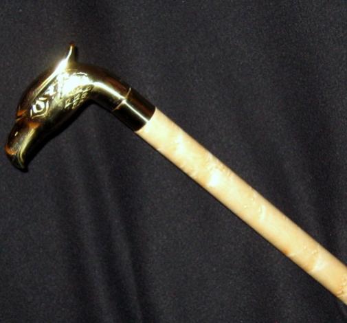

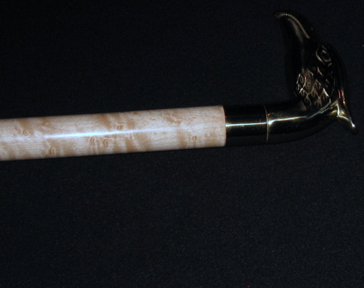

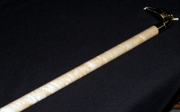

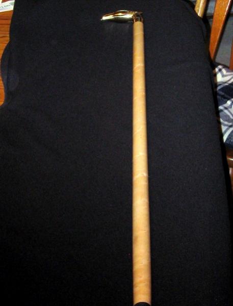

My first item turned on a lathe aside from a pen . Got the blank from Bellforest Products . The hardware is from CSUSA , and I finished the wood with friction polish also from CSUSA . I eliminated the bushings and turned it as one piece . By not having a center support , I had to sand it as opposed turn using tools . Thanks for looking . Any comments are welcomed . Sorry for the poor photography .

If you ever do another one look into a steady rest so you can use your turning tools and hopefully make it a little easier on yourself.
Either way though..beautiful piece.

Very fine job. That is beautiful and unique, I'm sure it will be appreciated.
The few canes I have made proved near impossible to turn, even with a steady rest.
Just too long and slender. I first cut down with a draw knife, then, like you, did the final work with sanding on the lathe. Tedious but possible.
Another approach is to use couplings and turn shorter sections.

Thank you all for the kind words . Being my first cane , and a gift that probably never be used by it's intended recipient , I simply guessed at a suitable length . Maybe someone who knows how this is done can answer the question .

I'm certainly no expert, but several years ago I made several. I turned them on a Crafsman lathe the had a 48" bed, and made them of various lengths. For my own use, I stood with my hand at my side, andwith my wrist bent at 90 degrees measured to the floor from my palm. This distance will vary with each individual, and I don't know that it is right, I just know it works for me.
I never had any sucess with the joyned canes, as they were never straight the way I made them, and they tended to loosen up with the vibration of walking.

Bob Thanks . That's pretty much what I did , and considered my cousin is 3 inches shorter than me . I have some pen photos posted on the Bellforest forum . And plan to send these photos to them . Not sure if they're good enough quality . Nice folks over there . Thanks for the comments .

I have made a few and from what I researched you should have the customer stand straight with hands down at his/her sides and mark the length at the wrist.
Total hight of the cane (Where the hand will rest) should hit the customer at the wrist so when they lean over they have good support. Too low they have to lean over too much and could fall, Too high and they may not have the arm strength to help hold themselves.
But my mom liked hers a little bit higher. I guess it would be a comfort thing.
