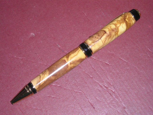

I just had to stick this pen picture in here, not because of any skill of mine, just because of the wood (thank you Diane in The Holy Land). This is NOT my choice of style for this wood, but my customers and everyone knows, "the customer is always right". Anyway, the wood was so unique I just had to show it.
