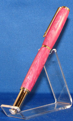

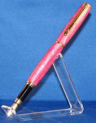

So, I decided to make an Artisan from Craft Supply. The material used was the last blank of several made by and given to me by our own Rootin Tootin Johnny Wooten. Very pretty stuff.

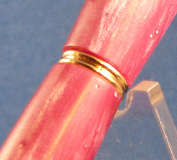

Turning was routine. Problems started with assembly. As you can see, there is no hardware at the bottom end of the cap. This leaves a very ugly, kinda 'naked' look. The top requires a recess cut for the clip. The instructions only say to cut a notch without explaining why, where, how. This is time consuming and a potential for disaster. I would reject this kit again if this feature were the only undesirable part of the process.
A flimsy plastic part must be inserted into the cap and sorta 'screwed' in for the pen to hold closed. This is awkward to do and was not successful for me. The plastic part can get torn up in the process very easily.
You will note in the close up photo that the bottom of the cap looks like I did not turn down properly. Not so. I turned down to the provided bushing. The sizing is what is wrong. Also, if you saw the pen in person, the cap looks like I did not square the blank and tube. Again, not so. They are squared but they do not fit on the parts squarely.
All in all, the end result is a total disaster.

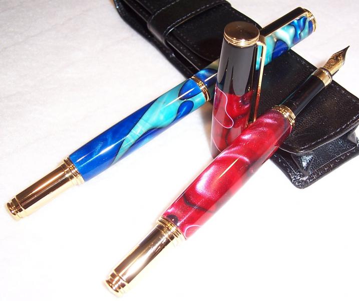

I forgot why but I uploaded the attached photo last year and these two pens have been in my desktop carosel since then and I have used them dozens and dozens or even hundreds of times and the caps snap on today just as snug as they did over a year ago.
I haven't sold but a couple but I have given away at least a dozen to friends and customers who wanted to try a fountain pen but didn't want to "risk" the cost of a "nice" pen. I actually attribute the sale of at least a couple "high end" pens to giving someone one of these "beginner" fountain pens!
Not a bad little pen, maybe I should write a mini review so members can decide for themselves.
