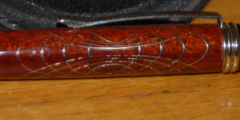

I just thought I should add, as well as the label issue one of the main reasons I don't use soda cans is because of the thickness of the aluminum. For most of the designs I make, where I am cutting through a previous inlay a number of times, it is very important to match the thickness of the blade kerf to the thickness of the inlay material. If you don't then basically you are putting back into the blank a different thickness to what you have just taken out so the blank will grow or shrink by that difference.
Not an issue if you are only cutting through a previous inlay once but if you are cutting through a previous inlay a number of times then the joints will start to stagger. Soda can is about 0.007" thick. The thinnest blade I have found is 0.011" thick. That difference of 0.004" starts to add up and can be seen.
The pen pictured sits on my desk and is the last time I used soda can for an inlay :rolleyes:

Well there you go again, thinking outside of the box :biggrin:
Vis,
Please send that disgusting example of poor craftmanship to me. I will deal with it.
