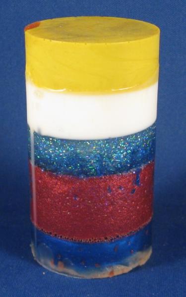

Eric, I do it all the time. Mostly just dump my excess into a bottle stopper mold. Sometimes they come out nice and sometimes you get this.
