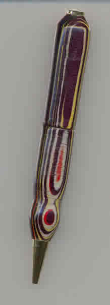

I like to delete the center band by basically not using the center bushing on my slimlines. I just separate them before I CA finish, and seal the ends with CA before final assembly. It works like a charm. Here is one example I like quite a bit:
attachment.php
