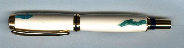

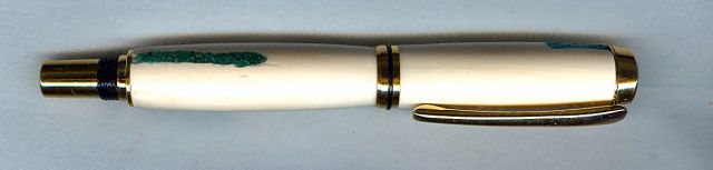

This pen is the result of a friendship that extends back several months. I have been collaborating with a South African artist on some music. During that time, he and I agreed to collaborate on a pen. I selected a 5/8" piece of pre-ban elephant ivory and turned it round. I then sent it to S.A. where he scribed a design, based on one of his paintings, and sent it back. The removed area was filled with ground turquoise and malachite, the blues and greens of his painting. Due to the extreme sensitivity of elephant ivory to heat and aridity, the blank was turned over several days and sanded over a week. There is no finish as it needs to breathe.
Comments and critiques are welcome.

<b>Randy</b>--ivory is highly sensitive to cracking and splitting. Excessive changes in temperature or excessive dryness are generally the culprit. I store my ivory in a cigar humidor. I've turned a few centerbands before which is where I found out, the hard way, about heat from tooling and sanding. I initially had turned and sanded the cb's just like they were wood. Two days later the cb's were split all the way through.
<b>Brent</b>--I used a 1/2" skew for turning. I checked the surface temperature as I went along and chose to stop when the temperature had increased by about five degrees. The piece was sanded from 220 through MM12000. After each grit (220, 320, 400 and MM1500) I let the piece rest for a day. For MM1800 through MM12000 I let the piece rest for at least two hours between each grit. Knowing me, this was probably overkill, but the blanks have been finished for 4 days prior to assembly and, knock on wood, no cracking or splitting.

Very nice Lou, just curious, seems like allot of ivory, how much was that blank?
If you don't mind sayin. I never bought ivory or priced it.

Great job Lou. You are right about it being very sensitive to temp.& humidity. I made one hear in MD. and sent it to Washington State. Fine when it left here,cracked when it got there. Again Very nice pen.

Originally posted by penworks
<br />Very nice Lou, just curious, seems like allot of ivory, how much was that blank?If you don't mind sayin. I never bought ivory or priced it.
For me, it's stupid expensive, Anthony. I've had this blank and a few 1/2"-ers for a while, but I think the 5/8" piece was $75. Needless to say, I don't stock many. [:D]
