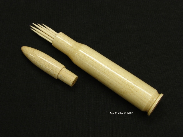

50 Caliber Tooth Pick Holders
See more from rd_ab_penman
rd_ab_penman
Jun 1, 2007
1,646
Red Deer, Alberta, Canada.
Turned using Birdseye Maple.
Sanded to 400x, buffed with super fine steel wool and applied 6 coats of MINWAX Oil Modified Water Based Polyurethane.
Got to like this stuff as it dries hard within 1-2 hours compared to the Oil Based with takes 4 hours to dry hard.
Also the Water Based dose not jell in the can after a time exposed to air like the Oil Based.
Les

Really great idea and the execution of the design looks flawless! I bet you could sell these along with the 50 cal pens as a set and make a killing.

Cool idea, but where did all the 'eyes' in the "Birdseye Maple" go?
Finish is top notch too.....
Scott (it's just Maple now?) B

Neat idea Les
I saw someone on another forum using a similar idea for a pen, rather than using brass cartridges.
Neat

Not sure if I'm supposed to do this or not but here's the pic I saved in my "I wanna try that someday" file.

Les,
Can you provide the general dimensions for the toothpick holder.
I'd like to copy your idea for a gift to my future son-in-law IF you don't mind.
Also, I found Paul Sherman's 50 Cal. tutorial for pens; I can probably pull dimensions from there and the 'net.
