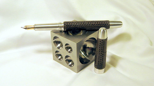

I finally got one finished. About a month ago I decided I wanted to take the plunge into kitless pens. The only problem was I didn't have a metal lathe to do what I wanted and secondly as a polymer guy I had very little experience turning anything, let alone metal. With the consent of LOML I purchase a used metal lathe from a friend who had all the tooling. Then I think I watched every video on YouTube dealing with turning, threading, and anything else metal. I am probably doing everything wrong, but I messed around enough and out popped a pen. This is my first complete pen. I made some nib sections, bodies, and half a cap (blew up) trying different designs, but this is the first complete pen.
The pen is aluminum with faux leather (polymer). I did the faux leather due to the fact my first pens were done with this design. It was what got me going so it was only fitting to dress my first kitless pen with the design.
Butch and George helped me tremendously and didn't make fun of me when I asked a stupid question.

Outstanding Keith , that is totally awesome . I was wondering when you would get it posted . The furnature design is fantastic and your PC leather work is amazing .
So , was kitless as bad as you expected it to be ?
Now for your next problem .... top that one :biggrin:

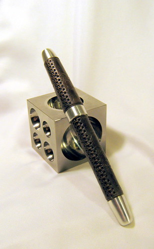

Beautiful !
But what about the aluminium's oxydation ? Do you applied CA or something else ?
What's this celulloid ?

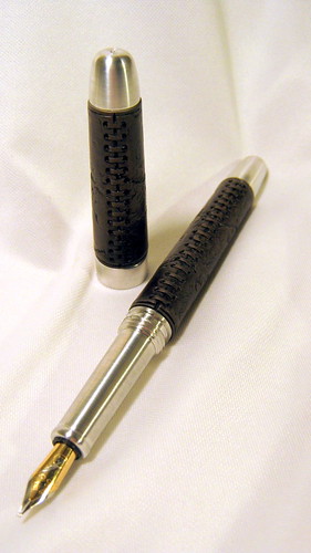

I used aluminum on this one to work through designs and for me it was a good learning metal (cheap). I got a couple 72' rods for $30 or so and I don't feel bad when something explodes (not literally) or I don't like a design and have to scrap the piece. I have read that a good automotive clear coat will help with this. Eventually I would like to move to stainless or even titanium, but I have a lot to learn.
Celluloid? I am not sure what you are asking on this one. The faux leather is polymer clay. I hand sculpt the laces and texture effects.

I have a combat solution for aluminum oxide. it's called a sink and some soap..go wash your hands..no big deal. Put some auto wax on it, that's going to stop it for a while then put on some more and wash your hands. If you are not writing with the pen for long periods of time, then you won't have to worry about a thing. You fingers will turn a bit black if you do..so just wash up and life goes on. I'd rather have an aluminum hand made pen and wash my hands after use then have a bic.

Car polish.....hmmm... I never would have thunk it! Thanks for the tip. This one is staying in my personnal stash so I may give that a try. Hand washing is always a good thing too!

I got to start saving for a metal lathe. You did a great job on that. Is the PC wrapped around a standard brass tube or is it a one piece aluminum with the PC wrapped oround that?
Lupe, it is solid aluminum. I made recesses in the body and the cap sections so I could wrap with polymer. I have used the faux leather on a kit pen before and I did wrap the tube. There are several parts to the process to get the leather to look like leather.
