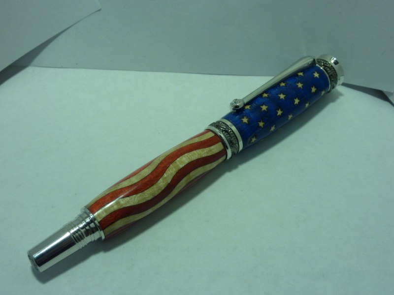

So here's a photo of the Majestic Jr/lazerlinez Stars & Stripes inlay that I did using the Woodchuck Pen Pro.
Look! No tool marks! No bleed of dust from red into white, or blue into white!
For finishing, a dab of sanding sealer, then, a few swipes with 600 paper, then, directly to CA finish.
