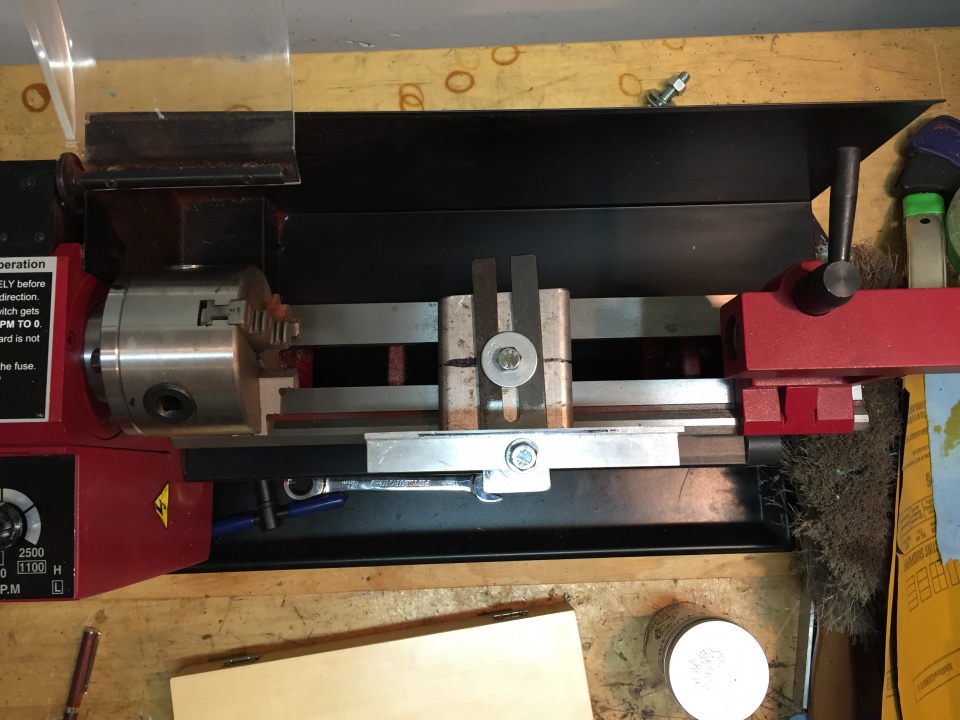

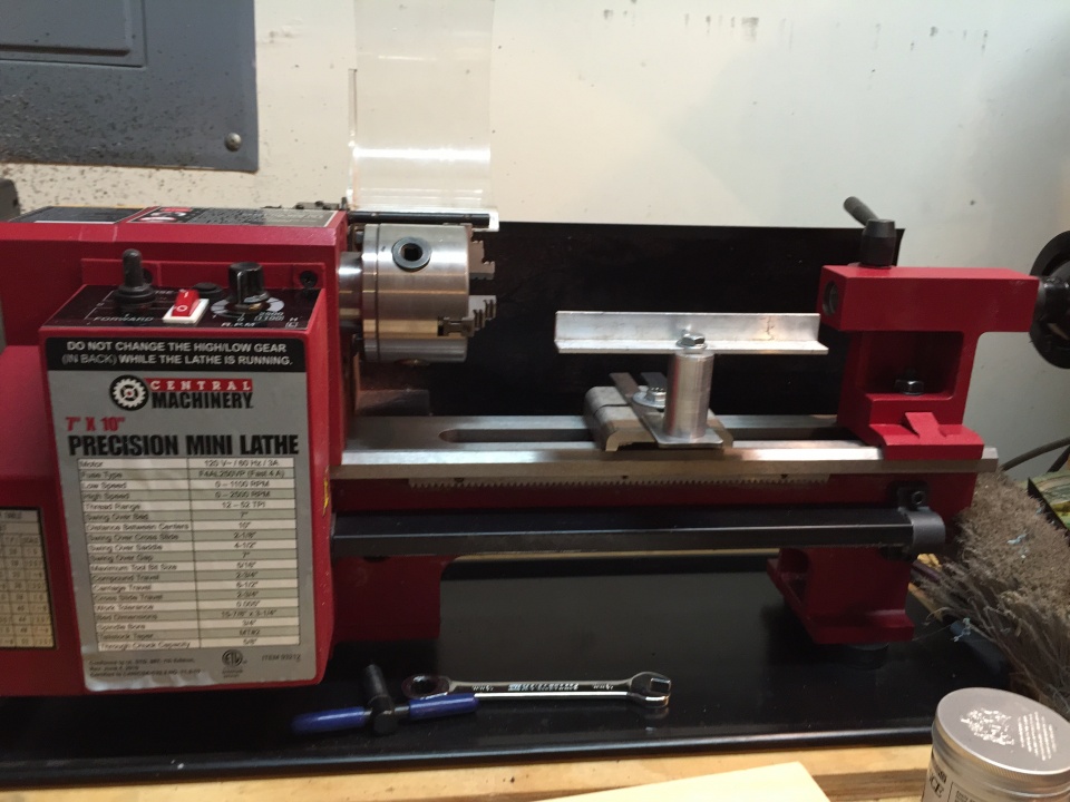

I'm turning on a 7x10 which is really only 8" between centers. Which I had the 7x12 when drilling. There are some limitations like only 2" travel in the tail stock requires you move the tail stock to drill the body and moving again to clear chips and again and again. Limited range in the compound makes it difficult to use it to cut long my tapers.
However I really enjoy the lathe and find it very adequate for pen turning. I wouldn't want to use it for a full time job but for nights and weekends it great. When turning wood I remove the carriage and use a tool rest I made and use it like a wood lathe and have plenty of room to work.
