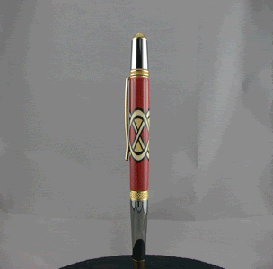

Hi Folks,
I am wanting to make a short video of my pen whilst it is rotating to try and show all the angles, much like you would do when you hold it in your hand. Any ideas on how to create a contraption that will rotate the pen around it's long axis nice and slow? I wonder if there might be some way of holding it in the lathe and rotating it by hand?
