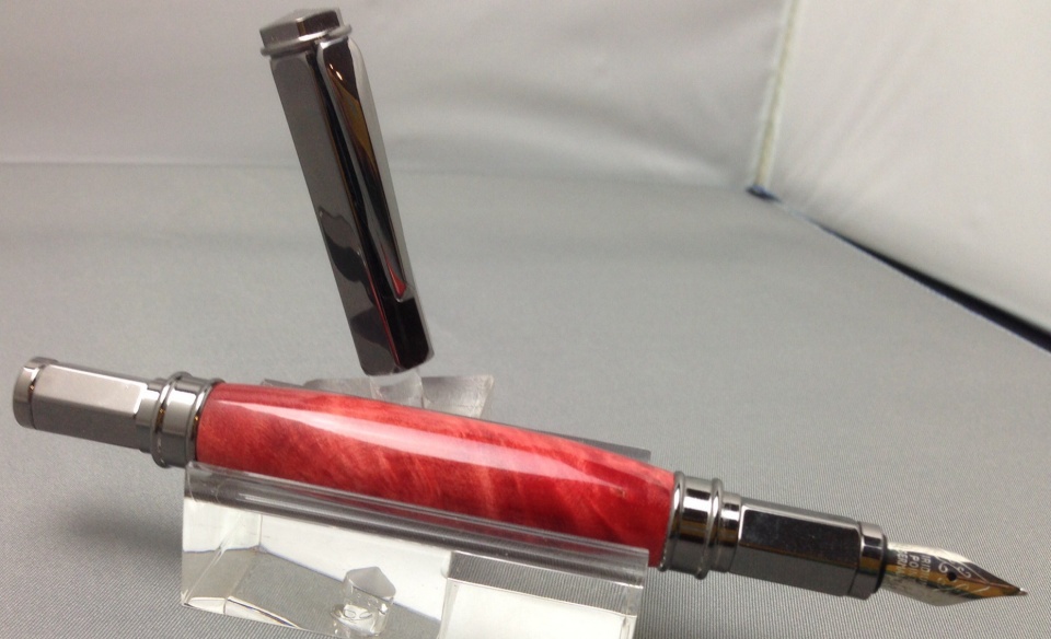

Magnetic vertex
This is my first one recently made. My husband is not crazy about the style. I like the feel and writes really well. I am going to give this as a birthday gift.
It was simple and easy to turn. I used this red buckeye burl.
