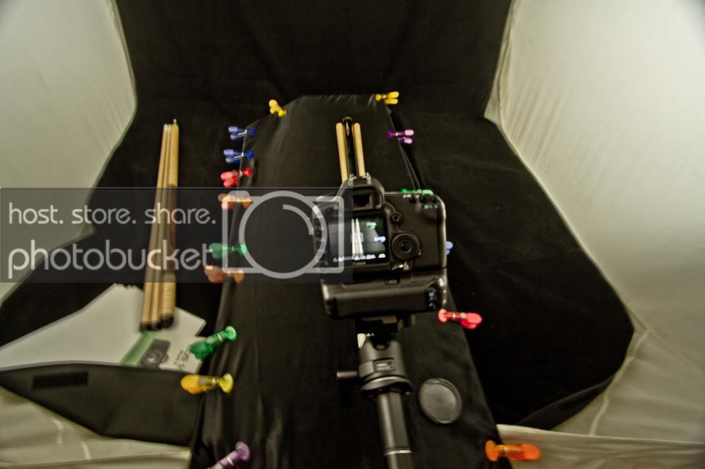

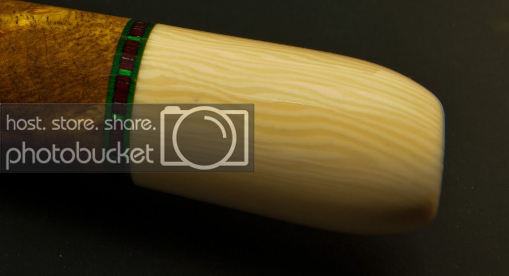

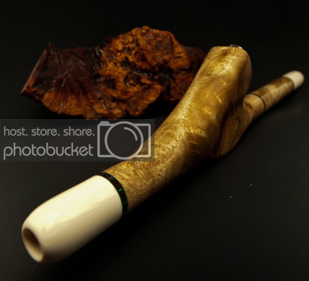

Hi how have you been .
As the pictures show above I am not really a pen maker .
And the few pens I do make I don't use a kit.
I hate using metal in with my wood working, so the chances are slim that I ill be doing photography on custom exotic wood with any kind of metals .
I know that really isn't the point .

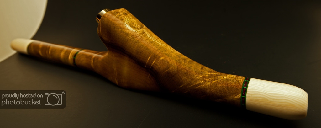

I think I found it! There's a pen photo at http://www.penturners.org/forum/f24/...9/#post1726819 right? Ok, I take it back - in all the time you've been on the IAP, you have posted ONE pen photo.
I presume this picture was taken using cross-polarization, is that correct? If so, let me point out that the majority of the nosecone and refill are unlit. The only part that is illuminated is the reflection of the backdrop material the pen is laying on. It shows up simply and solely because the diffuse reflection off the backdrop (because it has a matte surface) depolarizes the light from your softbox/polarizing film. The bottom of the nosecone is lit with depolarized light and therefore (being shiny metal) produces a depolarized direct reflection. The CPL filter on your lens only filters out half of that light, leaving the other half visible in the final photograph.
The top of the nosecone, however, is lit with polarized light (from your softbox/polarizing film). The nosecone (being shiny metal) produces a direct reflection that preserves the polarization state of the source light (i.e. it is polarized). The CPL filter on your lens filters out the polarized light almost entirely, leaving the top of the nosecone nearly black.
That is the problem with using cross-polarization to photograph pens. The same optical process that removes the direct reflection off the wood finish (which presents as glare), also removes the direct reflection off the shiny metal components - leaving them dark. The wood of the pen barrel(s) produces diffuse reflection that sill shows up, but the metal components do not.
