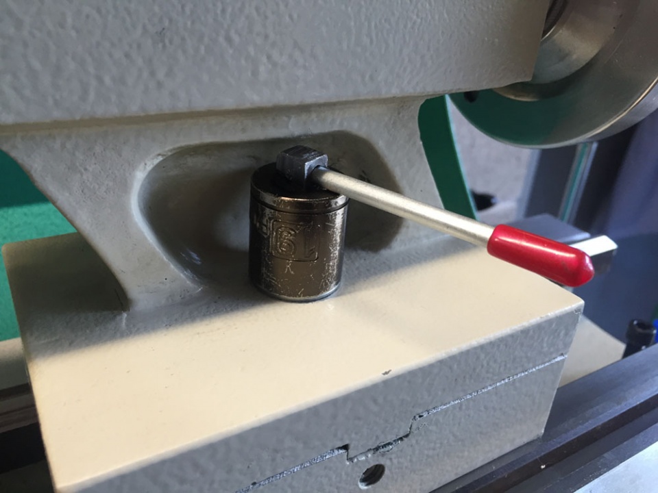

I use a little home made contraption to lock and release the tailstock to I can move it out of the work quickly. I'm able to get it to tighten down over most of the bed if I put it on just the right place on the nut.
Back to making pens now. : ) Thanks!!
