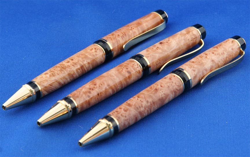

I originally had the pict below in the post "To Shine or Not To Shine." I realized that this pict could have been confusing because the other pict dealt with "shine and "mat" finish.
The picture below and this subject deals with Stabilizing blanks as it relates to finish. I wanted to know if different stabilizing agents would produce different tones, hues, warmth or whatever when finished. (This probably should be in the Stabilizing forum, but it has already been posted and My intent was how it affects finish.)
I am well aware of the differences in the warmth that oil based polyurethane (mixed 50/50 with mineral spirits) gives oak versus water based poly. My mom loved the "no fumes" of the water based poly on an oak dresser that I refinished in 2000 but didn't think it had the "warmth" of the oil based poly.
With that in my mind, and knowing that BLO and other oils do "pop" the grain versus when a straight CA is applied, I decided to see if there was a difference in the tone/warmth of (oil based) polyurethane versus acetone desolved polyacrylate plastic as a stabilizing agent.
The polyurethane cured blank is the first one on the left. It has a barely more reddish (warmth) tone but almost indistinguishable from the acetone/acryl stabilized blanks. However, there is one distinguishing feature of the polyurethane - that pen has much more and deeper chatoyance. It becomes more obvious outside and in bright lights.
While the polyurethane produced more chatoyance, it did not produce as much difference in tone or warmth as I would have thought.
The pen in the middle and on the right are acetone/acrylic stabilized.
ON this same subject: I also stabilized some Holly and some bloodwood in the oil based polyurethane; then stabilized another set of blanks of the same wood in the acetone/acryl solution.
OBP=Oil Based Polyurethane.
The OBP on the holly and bloodwood produced a slighter darker blank. I was surprised that after a week of curing the holly looked just like the acetone/acryl. I thought it would be more "aged" looking, especially since it looked like very old ivory when it was freshly taken out of the vac/pressure pot.
The Acetone/Acrylic (A/A) stabilized blanks revealed an unusual side effect too. ON the Holly, it looked normal. My original intent in buying a vac/pressure pot was to stabilize holly to prevent it from getting bleed over from other woods when segmenting and finishing. The A/A holly looks normal and turns fine.
A slight problem came about with the bloodwood and A/A. The bloodwood turned the A/A almost blood colored! Well duh! It also bleached it some. I showed my wife two bloodwood blanks, one from A/A and one from OBP and she immediately noticed the differences. The A/A stabilized bloodwood was/is lighter in color, even three weeks after I stabilized it. The OBP bloodwood still is darker. You can see the differences between them and a non-stabilized bloodwood.
The whole point of this experiment was to try and figure out the different stabilizing mediums have on different wood and how the effect the outcome in terms of color or warmth. I also want to lower the bleed over possibilites when segmenting wood.
My results are not scientific but I hope it spurs someone to take this to another level.
Greetings, Hank.
