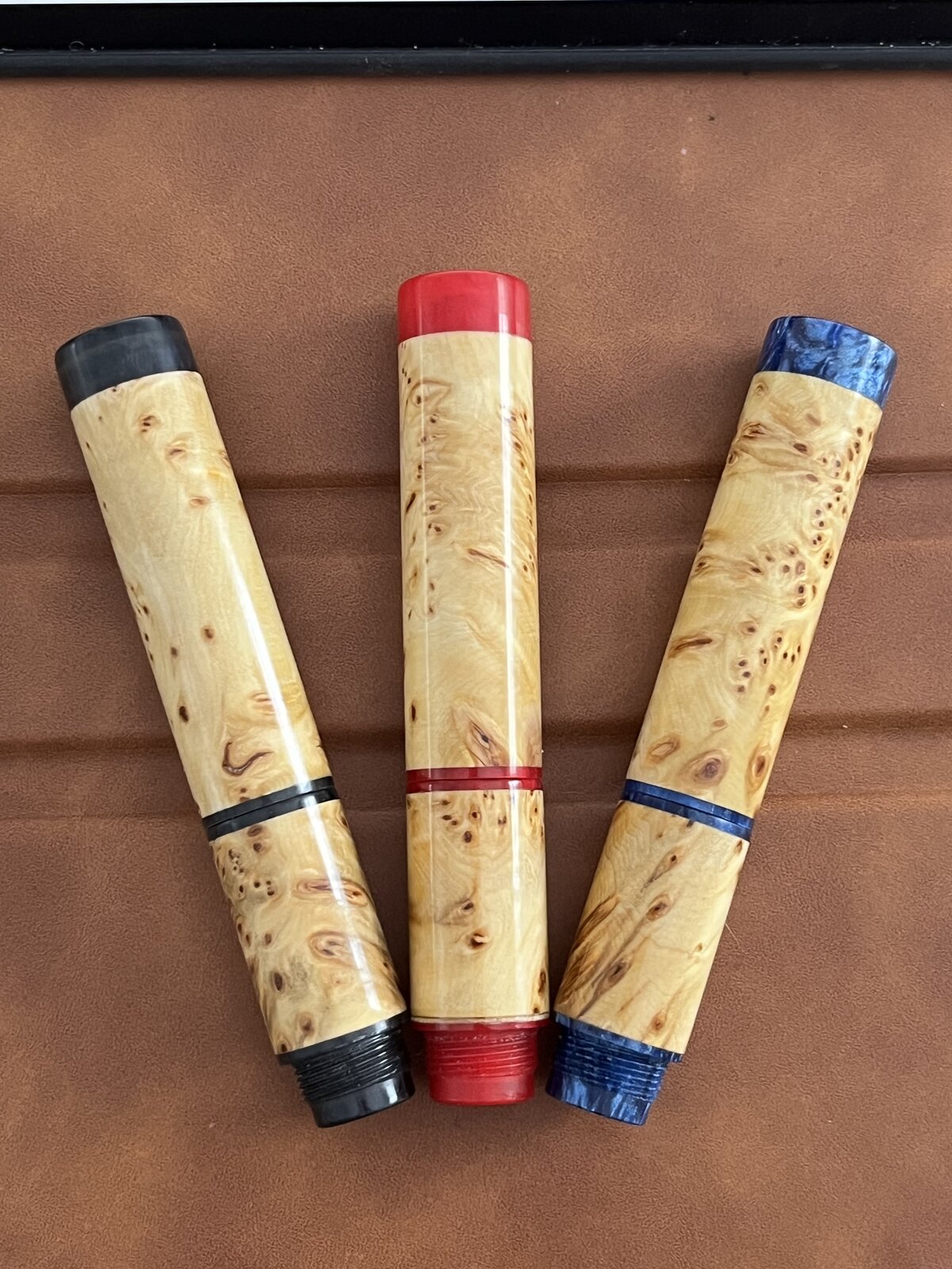

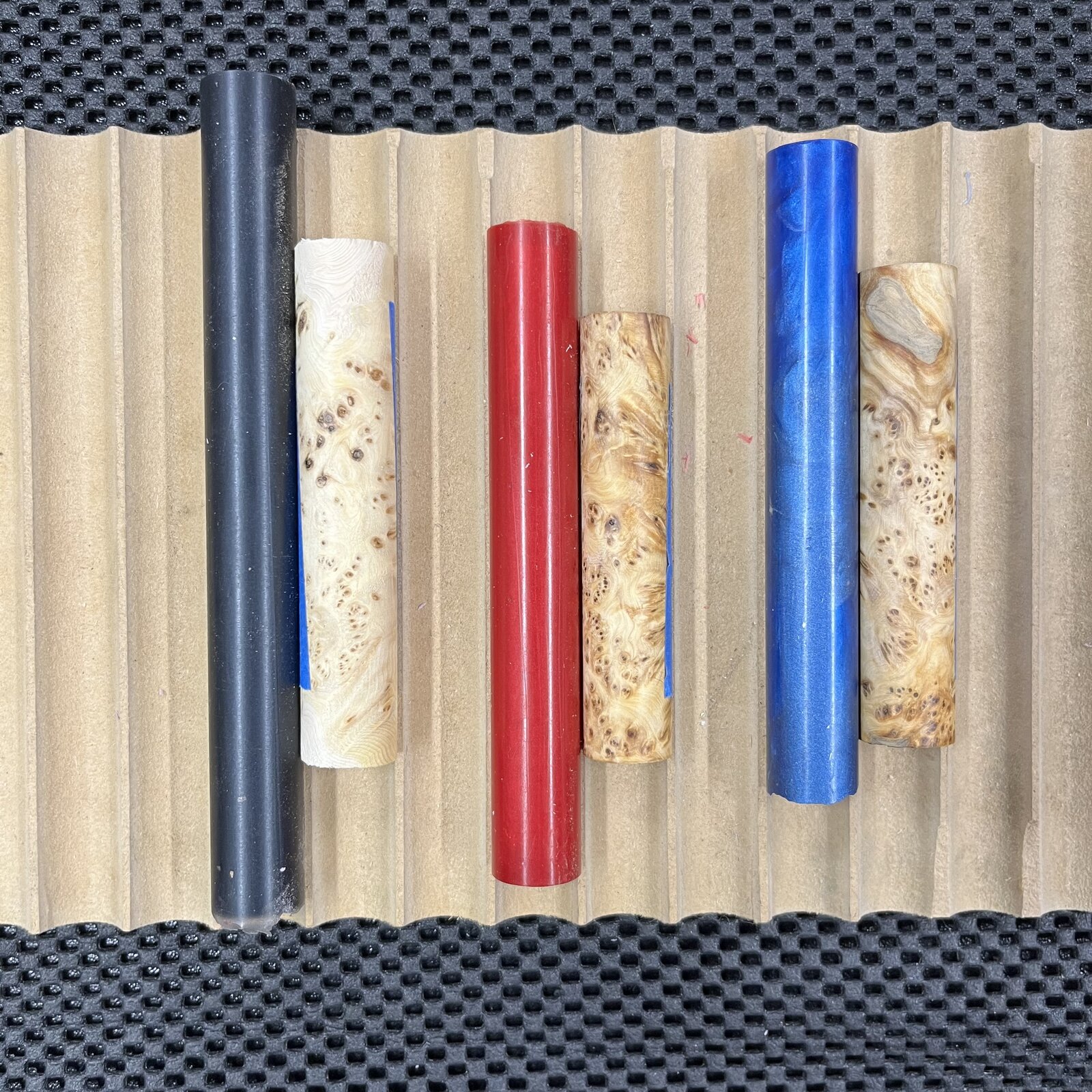

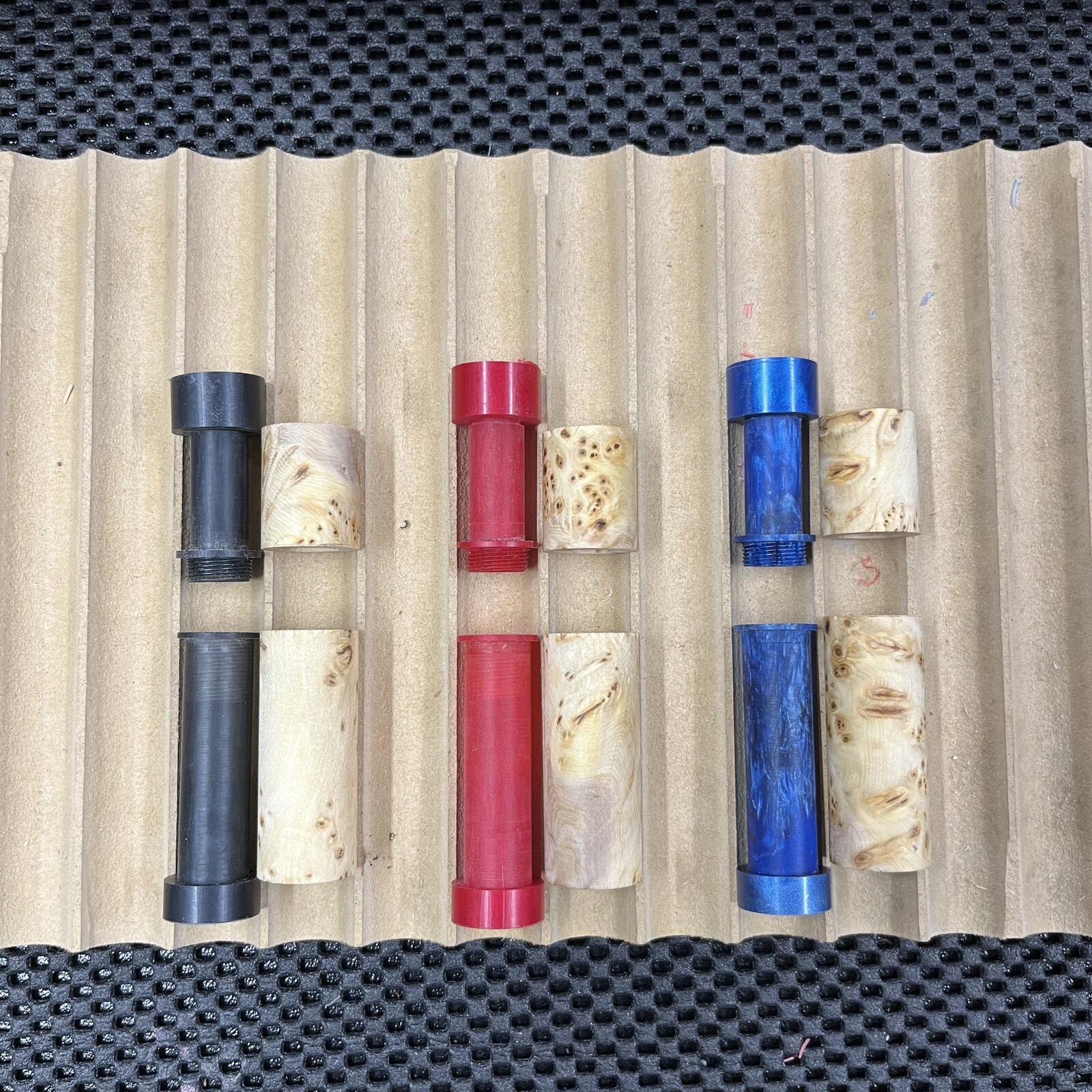

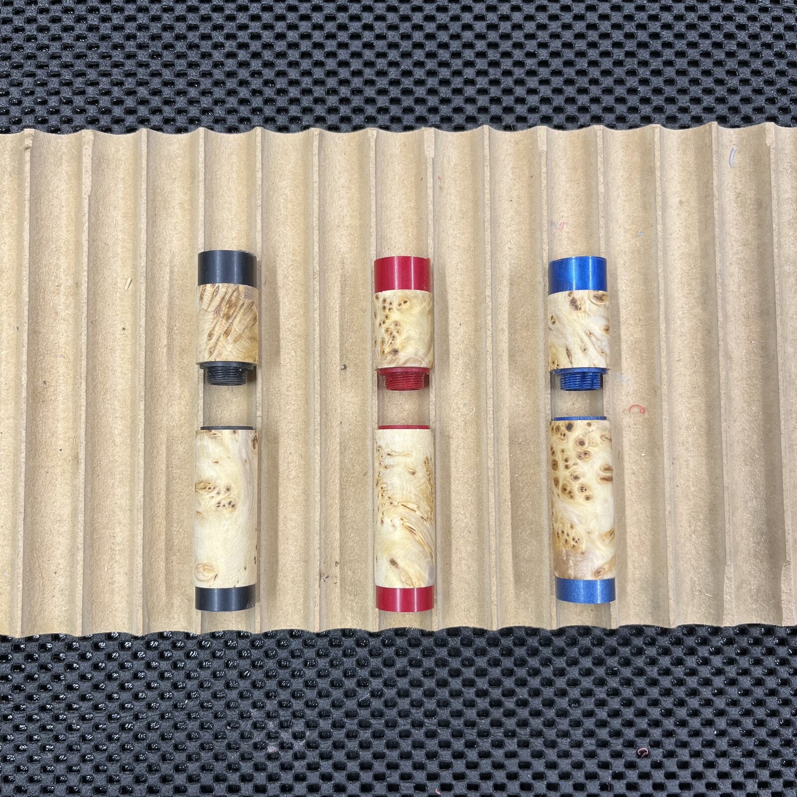

When I use wood for my custom pens, I always sleeve them with either Alumilite or ebonite.
Here is a couple of picture of my pocket pen using yellow cedar.
May 3, 2022
42
Sugar Creek Missouri
View attachment 351971View attachment 351974View attachment 351972View attachment 351973
Curious how you attach the end caps/finials. Are they a slip fit and epoxied or are they threaded on? I think I saw one of your other posts about this style. It is designed around cartridges, correct? Very nice pens!
Good morning Frank.
'Thanks. Yes, the finials are slip fit and all three pieces are epoxied. These ones are designed to just fit a single Standard International Cartridge.
