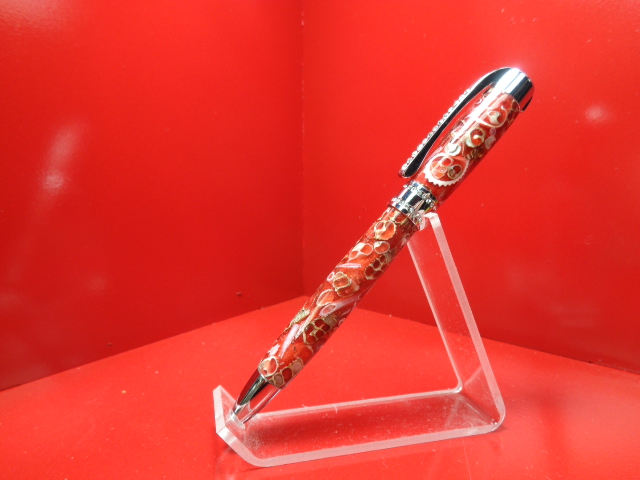

tonylumps
Nov 7, 2016
164
newtown square pa
The first time I bought 3 blanks.The first one Came out perfect.The next 2 blew off the lathe .I said no more sea shells.Oh and of course the band saw blade was trashed on the first blank.My wife took the pen for herself.She works down the airport so everybody wants one.Bought 2 more.Used a cut off wheel to cut the blank to size.that worked. Then I used an angled air grinder with 60 Grit SP on the lathe at 800 RPM to bring the blank close to the bushings and finished the rest by hand.Came out great.But I will not do that again until the weather breaks and I could open up the garage door with my 30" fan blowing outside.I have Vac at the lathe,Box fan with filter and and Air Filtration hanging from ceiling.The dust was just to much for what I had. Here is a shot of the second pen.
