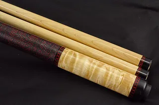

Automotive paint both racks that rotate the pens wood ,, the more the better Emron clear works really good but toxic.
a Commercial buffer, and you can do hundreds at the same time.
I can buff out a pool cue butt in a minute or two max .

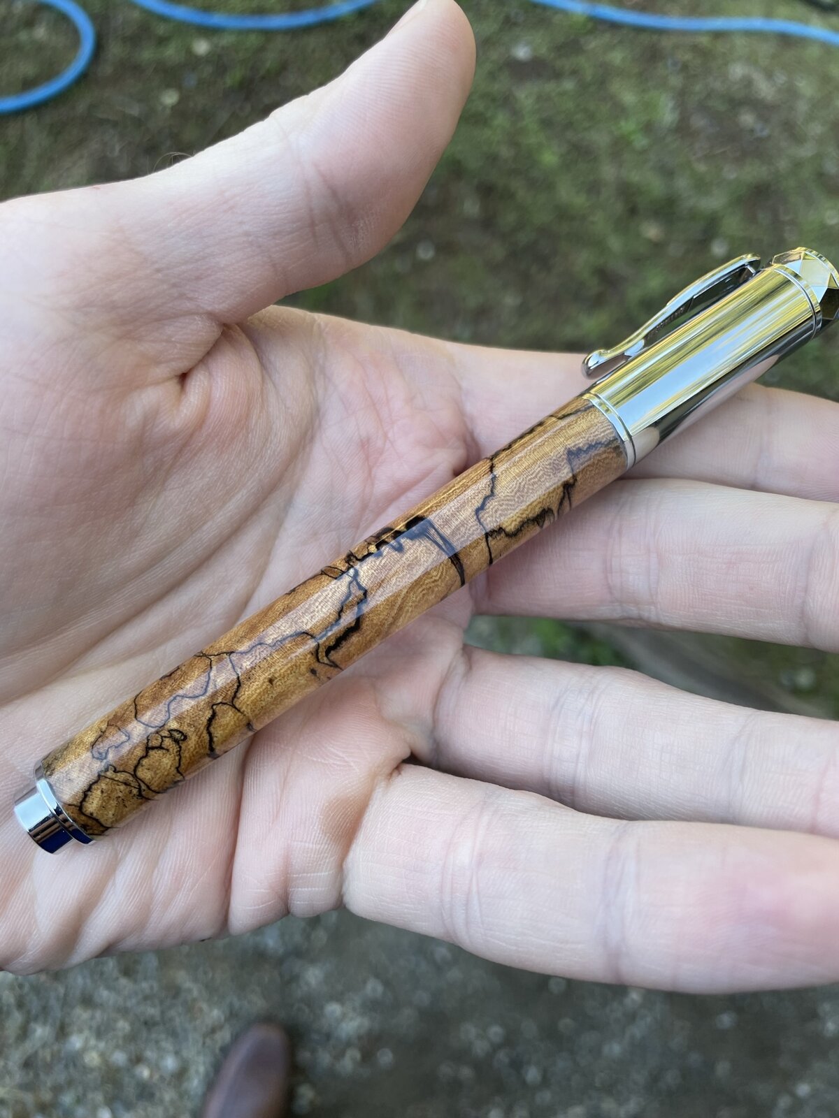

I'm a relatively new pen turner and tried wipe on poly and some other "quick fixes" Like a couple others on this thread, I settled on Dr's workshop Pens Plus. Super easy to use, I typically use 3-4 coats applied with a blue shop towel. Done in a matter of minutes.
It takes me about 5 minutes to apply 14 coats of two thicknesses of CA glue. It is fast and really has the results you want as opposed to other quick fixes that leave inferior results.

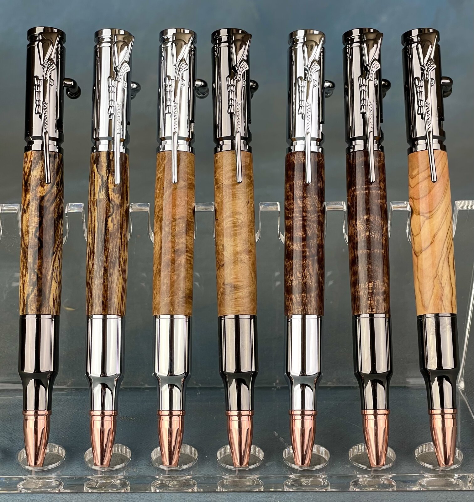

I read lots of people on this forum in search of fast, easy CA - like finishes for their pens. This is real CA finish, 14 coats of it! It took 1-1/2 hours: turning, sanding, cleaning, CA application, end sanding, end sealing, sanding and buffing. The CA application took about 1-2 minutes per pen - to me that's quick.
Your mileage may vary…
