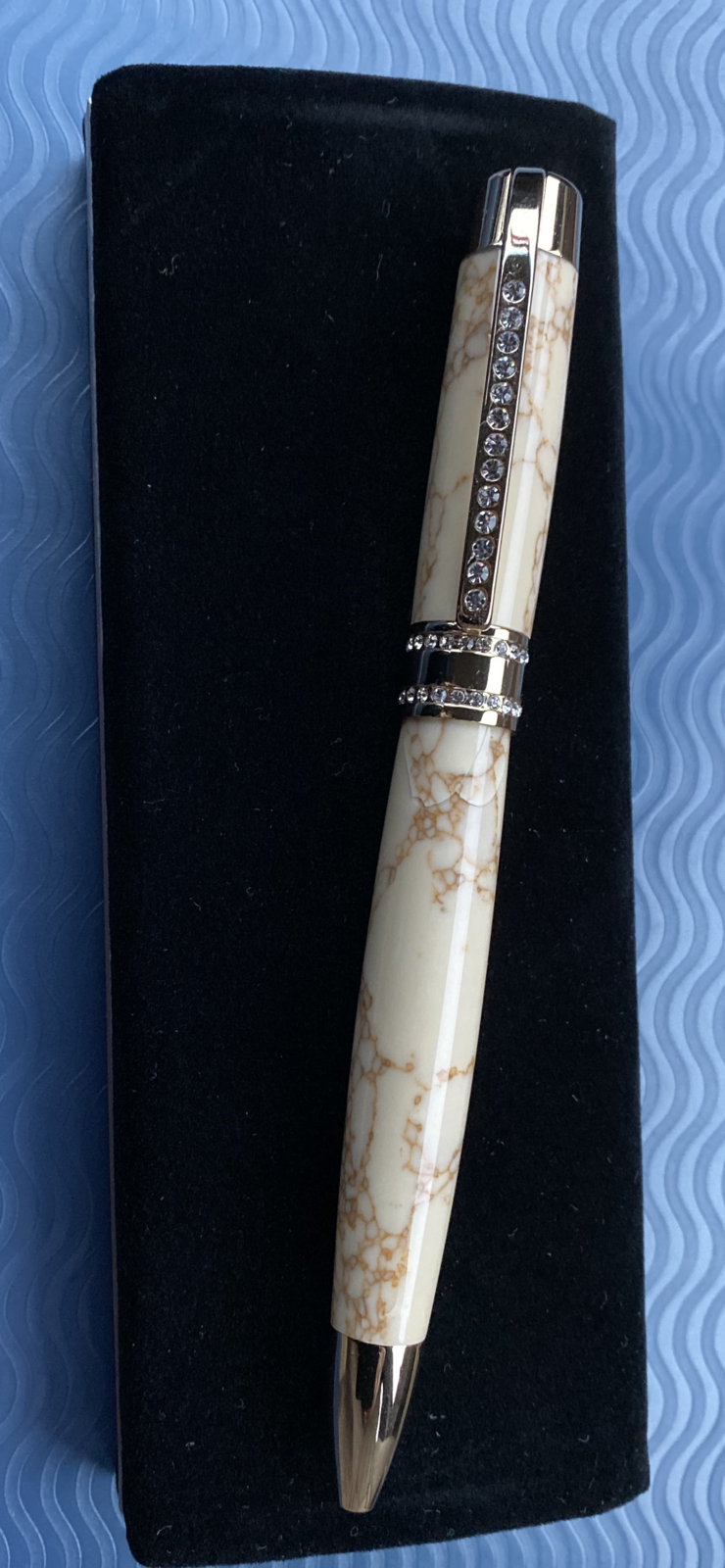

What can I do to keep tru-stone or in this case Penn-stone from cracking when pressing the parts together? The tube seems too thin to grind for relief and glue parts in.

Is it the stone that cracked or the finish on top?? It looks like an acrylic finish on top. Did you do a CA finish or something else on top?? The best way is to file the inside of the tube down and have a slip fit of the components and then use blue locktite to glue in. You really should do this for any fragile thin blank. Nothing wrong with doing this. Plus you do need to have both parts and blank as straight as possible when pressing in. Usually a finger fit works best.

Thanks for y'all's comments on filing, I'll do it over and file the tubes before assembling.
No CA finish just micro meshed and buffed with cotton wheel loaded with a carnuba wax bar.

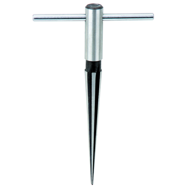

Head down to your local sporting goods store and make sure it has a gun section. Pick yourself up a set of bore cleaning brushes and a reloading hand reamer. Before you assemble your pen, run the bore brush down the inside of the tube and use the reamer to remove any burrs on the inside of the tube.
