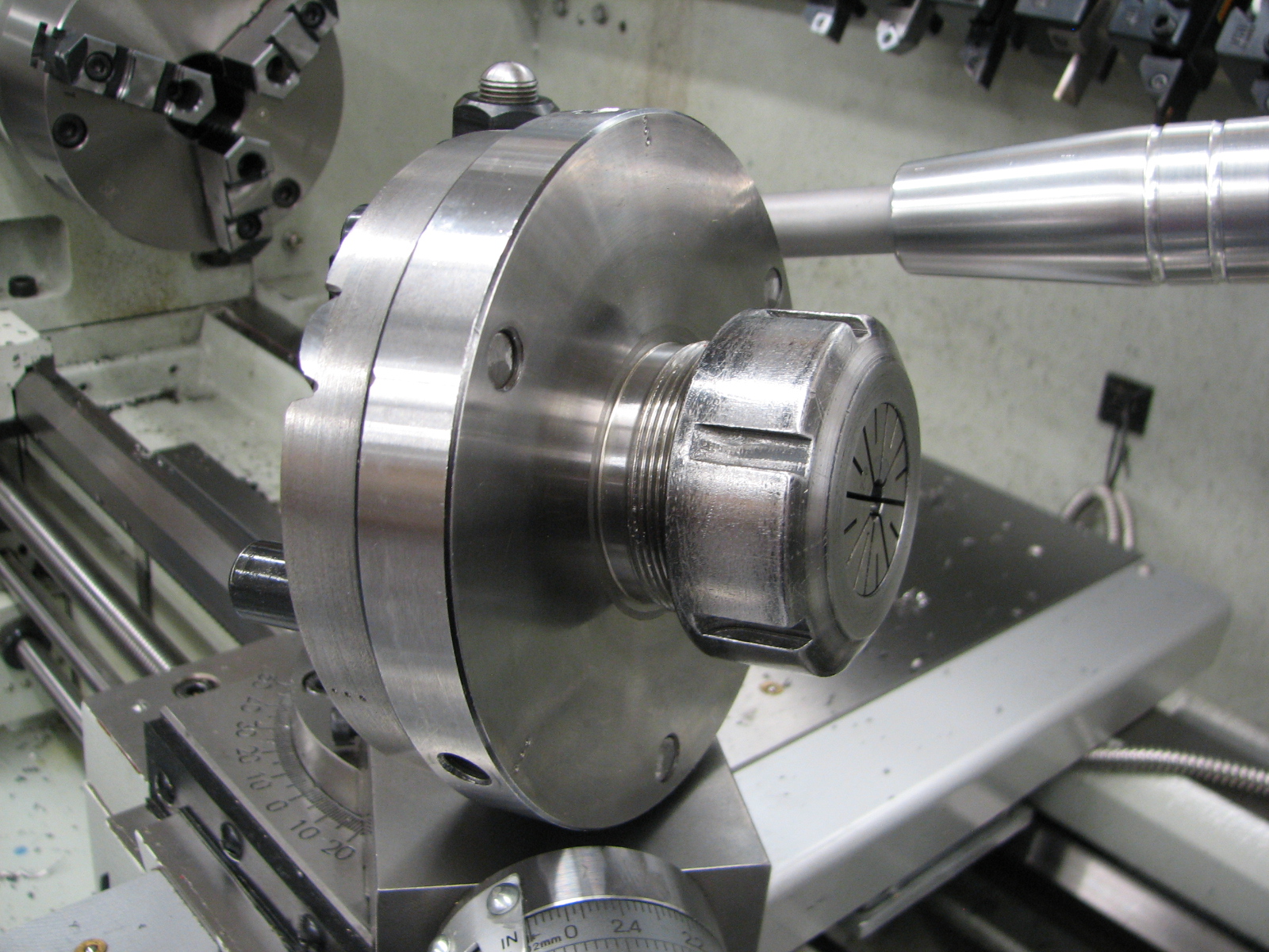

Please be aware Carl that a 5C collet has almost no range. An ER collet has a range of +.002" -.040", a 5C has to be pretty much spot on, only +.002" -.015". Also, an ER collet collapses along its whole length, when you collapse a 5C more than a couple thou it doesn't hold along its whole length making your work piece prone to push away from your tool bit if you take a heavy cut.
I use ER40 collets on my metal lathe, I bought a 5C chuck and I never use it!:biggrin:

I have a 5C chuck so unlikely to spend the extra to get an ER too but wanted to ask for others. I did the same sort of search and found that thread too.
The one thing I like about the 5C collets is that a stop can be added to setup for repetitive cutting. Really handy for trimming tubes to length from 10" lengths for kit pens. ;)

Looks like ER40 is the way to go for D1-4. Well, the collet chuck is cheap. The metric collet sets don't seem to be so cheap. Bummer
