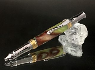

Yes, however IMO it doesn't do much to make the photo more dramatic. Gradient or black paper or fabric and an indirect or reflected light do a fine job. For some "punch" a mirror or tinted plexi under the pen adds a nice touch like in elkhorn's photo.
