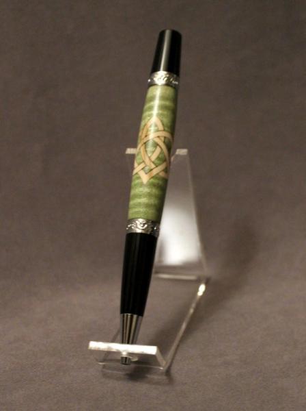

I had grabbed the same Celtic knot kit that Dave made for th demo. I had a bad failure while turning it, a chunk of the green broke out and flew off. I found it and glued it back in and surprisingly the break isn't visible after the finish was applied. All in all it was a good experience.

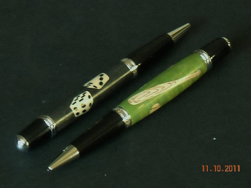

Well, my sons turned their lazerlines kits today and they turned out really well. They used the woodturners finish that was demo'ed at the meeting and that seemed to do a very nice job. One kit was given five coats and one was given eight. I think we might have been a little conservative with the finish so it might be more like three and five coats. The baseball kit pieces had a very good fit and you couldn't see any tube. The dice kit wasn't quite as nice a fit plus all the dots needed to be filled. We followed some advice and used charcoal powder and the Starbond CA to fill it in(thanks, Dave) and that turned out great. We're going to work on taking some decent pictures and uploading them to the site in the next few days. But all in all it was not as daunting a project as we thought it might be. Defintely plan to do some more of the laser kits.

Ok here is a picture of the Lazerlines wall street 2 pens my boys turned on Sunday. It's the best picture out of a dozen. I'm looking forward to the photo demo at the next meeting.

Looks like they did a great job with them! I still havn't turned mine cause I've had a cold for the last week :(

OK I've shamed into finishing my demo pen.
Who else has finished there's? Prove it with pics.
Here's mine. :)

Very nice looking pens. Great job. I have around twelve kits to do I cannot wait to get back into the shop.

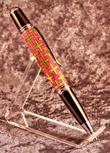

I was a little too anxious to get my cross pattern pen completed and neglected to paint the tube so there are a couple spots where if you're looking at just the right angle you can see brass. I'd have tried using tinted epoxy as a filler if I'd caught it earlier in the process... but I have no idea what color I'd use to match fuchsia and chartreuse (yeah, the colors in the picture are pretty accurate :eek:). Still, the assembly was fairly easy and I had it done the weekend after meeting using a two-tone black Ti Sierra kit.
Like others in this thread I also used the General Finishes sample and am happy to report that it worked just fine in an unheated shop at about 40 degrees with only about five minutes between each of the six coats... which is better results than I've had with CA finishes I've attempted lately...

Nice job.
I've started painting the tubes on all the inlay kits. If need be I use powdered charcoal to fill any gaps between pieces, not that that would have worked on yours because of the colors. What you can do is take a piece of left over wood if there is any and make saw dust with it and use that and CA to fill.
