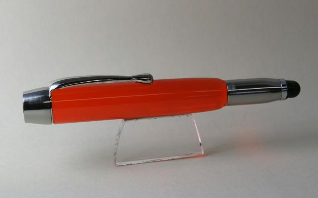

Hope it is ok to put projects in here. On kit pens the nibs and finals are pressed into a brass tube. The nib and final on this stylus are pressed onto at tenons cut on a Lucite blank. Both the nib and final were machined from solid 5/8" titanium rod in involved turning to size, taper cuts and drilling on the lathe. The stylus point was purchased and the blank is clear red Lucite.

John, the stylus looks good. What did you use to drill on the titanium? Carbide, cobalt or just HSS?
HHS

I was trying to show the metal part more than the completed stylus. I believe my metal lathe has paid for itself many times over through various repairs. Some of the parts are pretty high priced considering the man hours in them.
