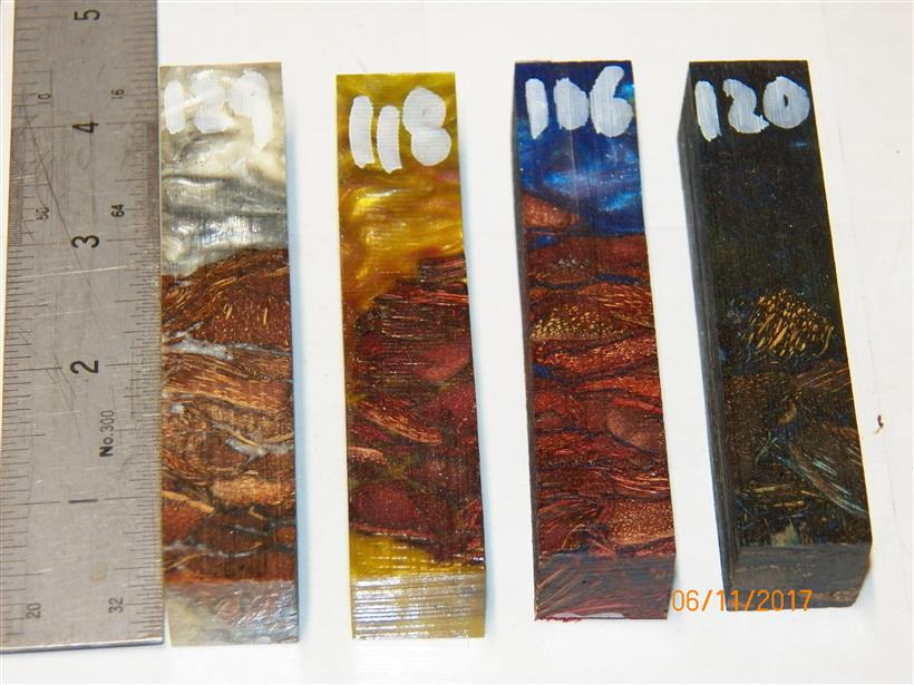

This is a cross post, from show off your pens, but thought it would be good to post here as well.
I received my blanks from George this week, and turned this beauty yesterday.
Working with this blank was very easy. I am not an overly experienced turner, as I have only been turning for about a year, but I do turn a lot of Rhino plastic, which seems to be kinda brittle as opposed to other acrylic I have turned, so I have learned to take things slow, and keep my tools really sharp.
I painted the tube blue, as I didn't want to find out to late, that the acrylic part would show through.
I sharpened both of my skews, and both of my roughing gouges right before turning this blank. The acrylic portion turned like normal, run of the mill acrylic. It didn't "feel" brittle under the roughing gouge or the skew. The coconut husk kind of turned to dust under both the roughing gouge and the skew. Not in a bad way, as the blank was very solid, It just didn't ribbon, or shave off, but "dusted" off. I took gentle cuts with it, but that was because I didn't want to screw it up.
After I turned it to shape, I lightly sanded with 600 dry. The Coconut husk sands beautifully. I then wet sanded, still on the lathe from 1500, to 12k with micro mesh. I wiped it down between each pad to get the "slurry" off of it, as I didn't know how it would react. After sanding to 12k, I stopped the lathe, and took a good look. I noticed that there were a few places on the coconut husk, that didn't polish. Most of it had, but a few places it hadn't. I applied 4 coats of thin CA glue, letting it dry about 5 minutes between coats. After the 4th coat, I removed it from the lathe, and placed it on a peg to dry for about an hour. I don't use accelerator. I then put it back on the lathe and re-sanded it with my micro mesh pads from 1500 to 12k, then buffed it with a quick coat of Maquire's for a really deep shine.
George, once again, I really appreciate the "Offer" and I look forward to turning the other 3 blanks. They haven't told me what kind of pen they want to be yet, but they will when it is their time.
P.S. If I may ask, what is in your acrylic, that adds the micro glitter? I really love it.

Thanks for your detailed description of your experience with this particular type of blank.
I use epoxy resin it has better qualities than the Polyester that can be brittle in occasions. Yes, you couldn't expect ribbons from the stabilised coconut husk as even stabilised woods turns to bust when turned, the coconut husk being a compressed bunch of fibres would never produce ribbons when turned.
As for the "micro gliter" effect you are referring to, part of it is a natural look of many Pearlex powders used in the resin, some colours show it more than others however, I also tend to use Micro-Pearl to accentuate that effect.
I'm sure you will work out what kits will go with the other blanks, I look forwards to seem them
