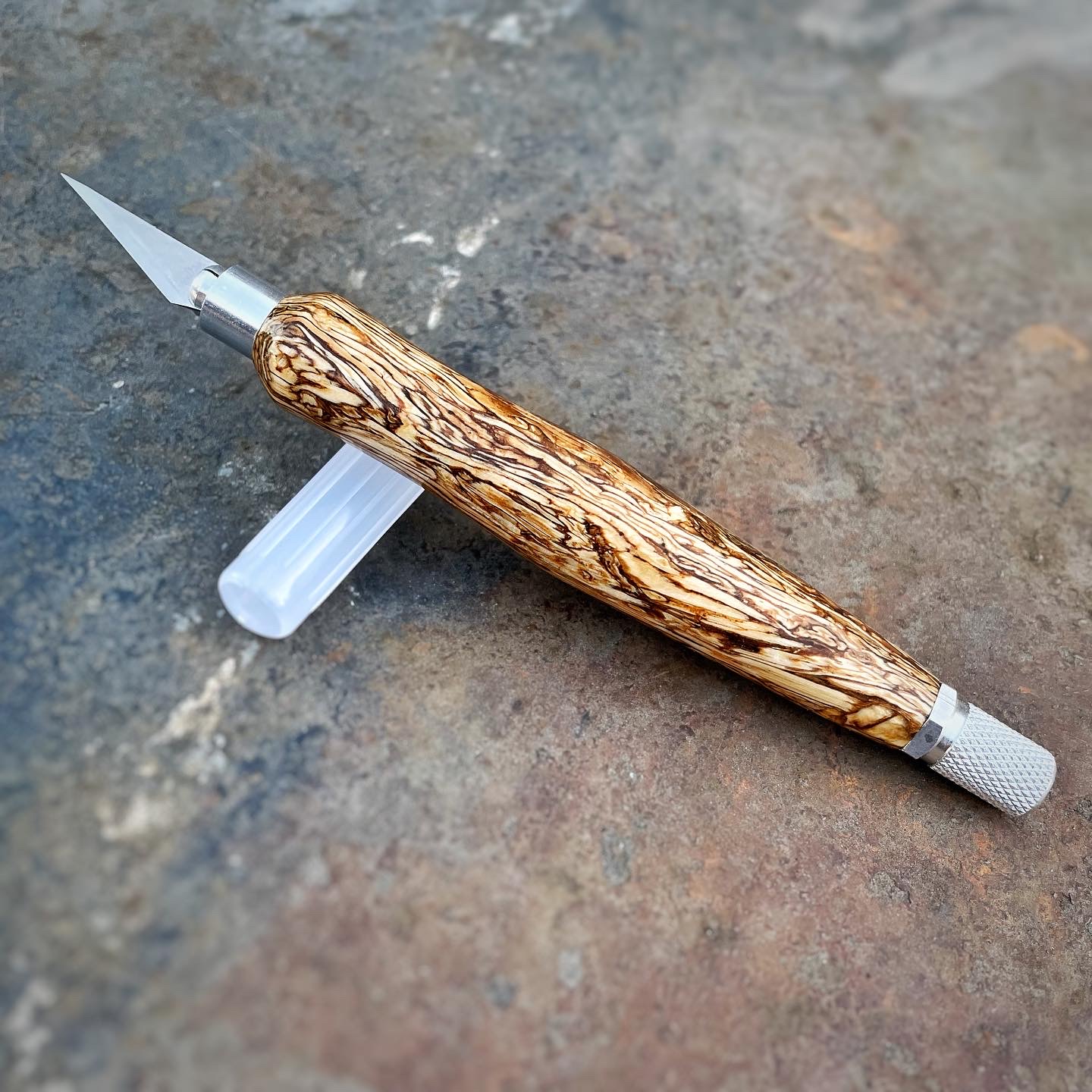

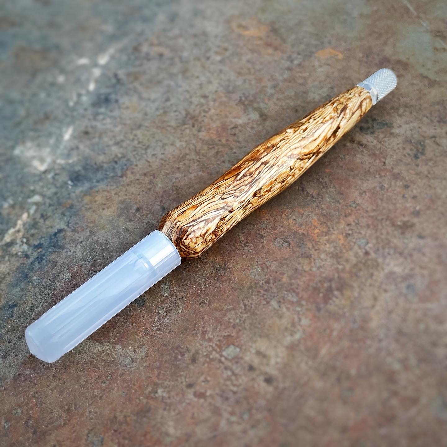

Exploring some new shapes and how aggressive I can get while turning our (Bullseye) improved HempWood material, this hobby knife / craft knife / whatever you want to call it was the result. My favorite part is that it's not a kit, it's a store-bought knife that's modified with a turned handle
Start with this blade, unscrew the parts and knock out the one piece that's pressed in. Use an 8mm replacement tube cut to the correct size and the blank of your choice. Once you're prepped, tiny giant/editor bushings get the job done and you shape it however you like.
Hope that's helpful. I make loads of these in a lot of different materials

I got my knives today, haven't done much except some preliminary measurements. I have some questions though. The pressed in part fits very sloppily in a 8mm tube, how are you dealing with the slop? Do you really even need a brass tube? The entire knife doesn't fit to bad inside a 10.5 mm tube, might that be an option?
I had to buy 8mm tubes (got them from Exotic Blanks), and there was no slop between the tube and the "Blade Section" that is pressed in. It was actually a pretty tight fit. On the other end, the "Nut" section just tightens when screwed into the Blade section, removing any slop/movement.
That's odd, I have 8mm tubes and they are very sloppy. I'll look again tomorrow
The only advice I can offer is to turn down the knurling on the aluminum top piece before pressing it into the tube. It is slightly larger than the 8mm tube and I was worried about cracking the acrylic since it is pretty thin in that area. Even if you make it level with the surrounding aluminum, it is still a press fit.
The aluminum knurling is super soft though and presses in fine with no issues - fwiw
