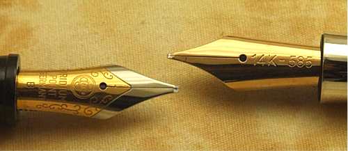

Here are a couple of pics of some reground nibs. The first two are by John M. at Nibs.com. I really like his work, but took to grinding my own, because I did not like having to wait 6 months for a nib. They are both ground to a cursive italic. Left is a Parker Duofold and a Pelikan.
Here are a couple I re ground into cursice italic's, left is a Brea & right is a 14K Penchetta nib.
Hope this sheds some filings on the subject :D
