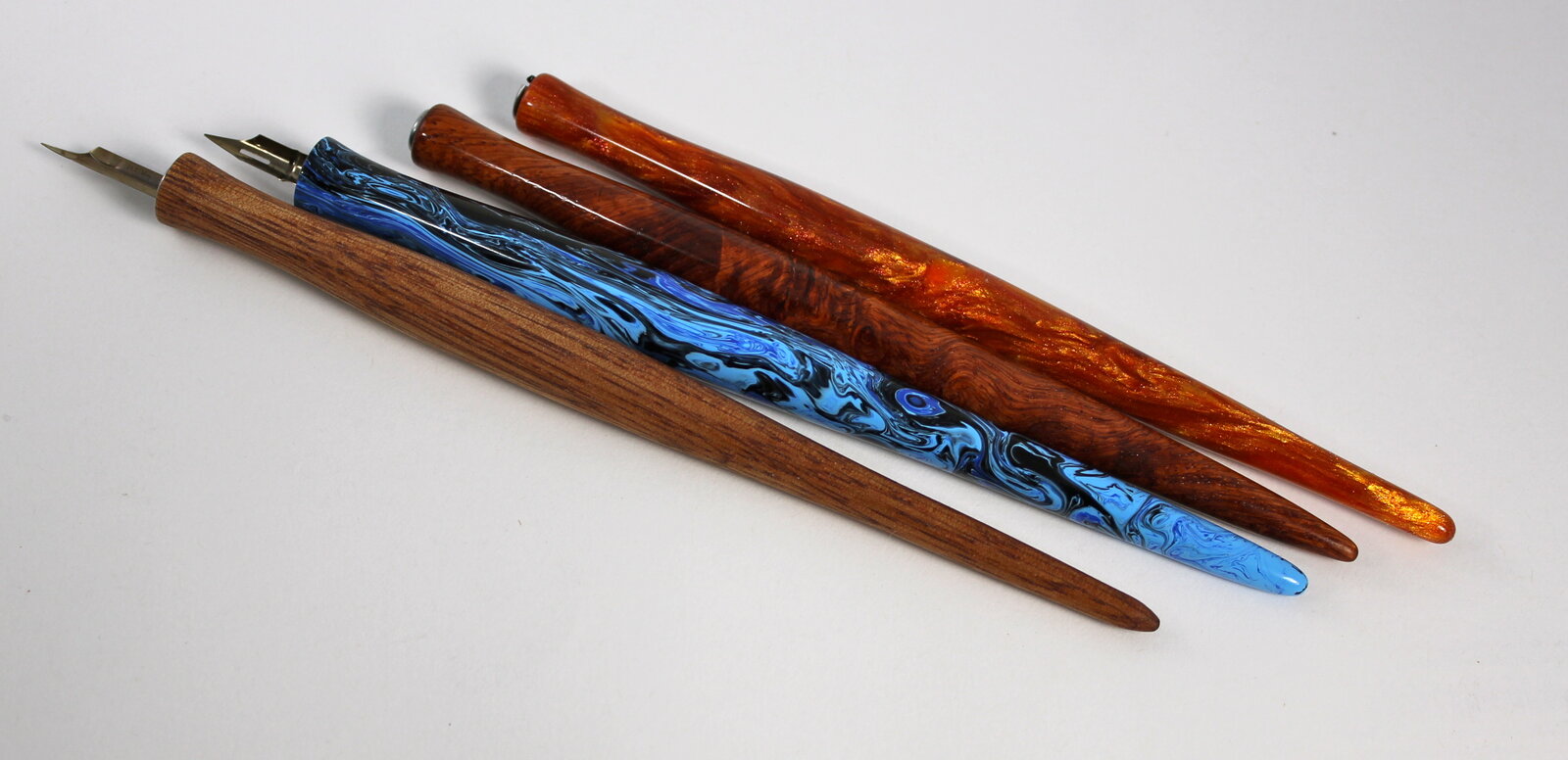

Not sure if this is where you want to go, but with some practice, dip pens with different nibs are very feasible. These are a few I did a few years back. Nothing special, but the recipient says they are still being used for ink drawings.
