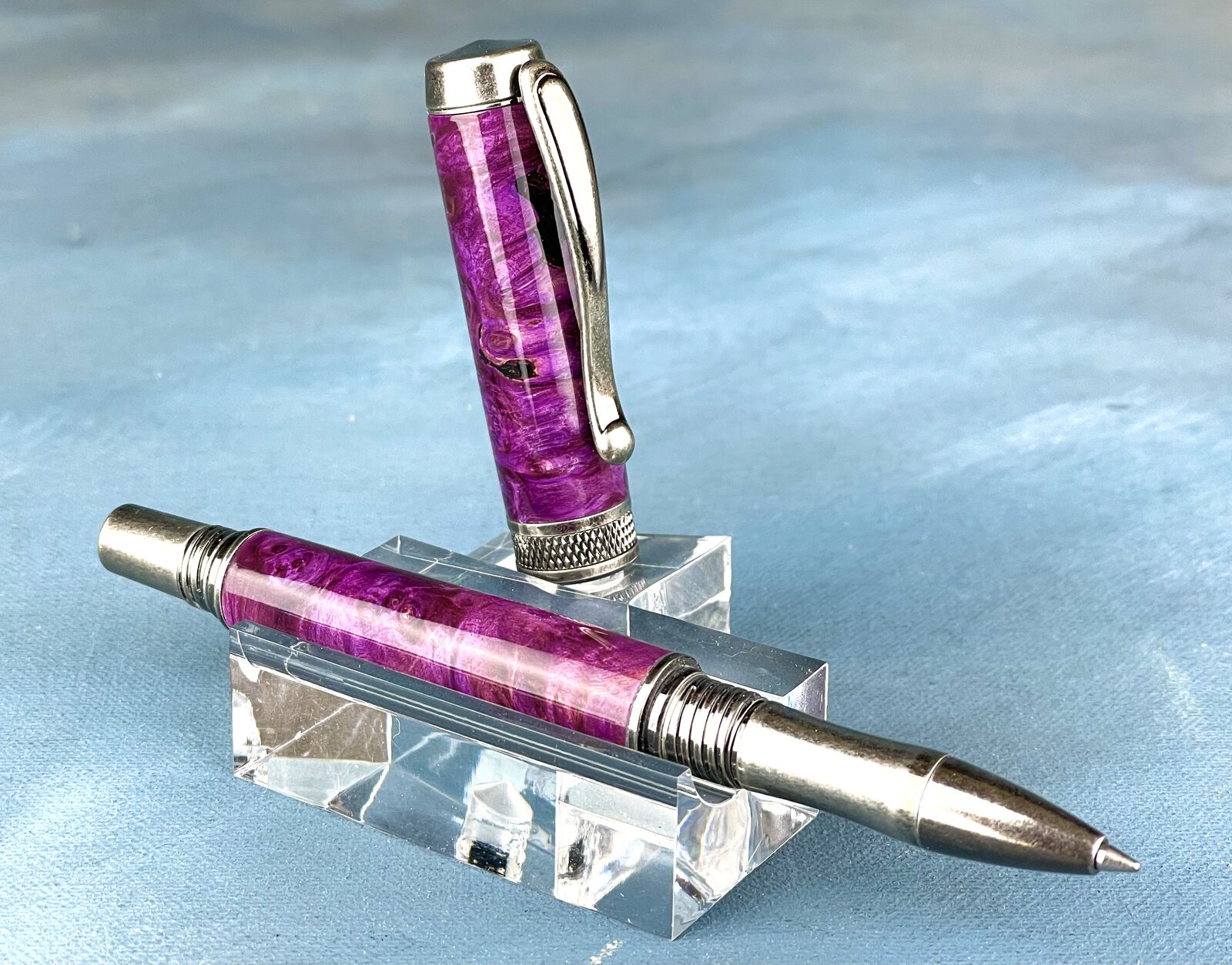

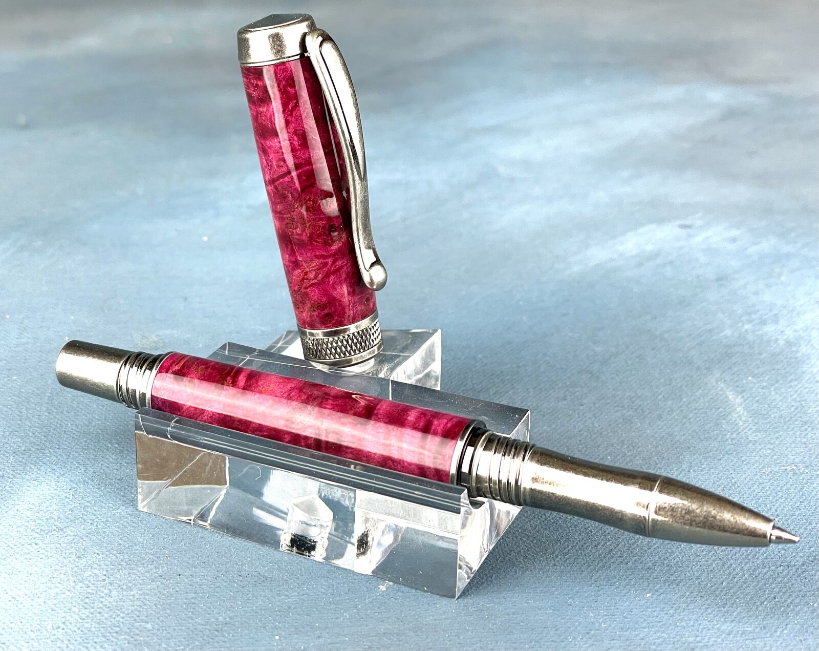

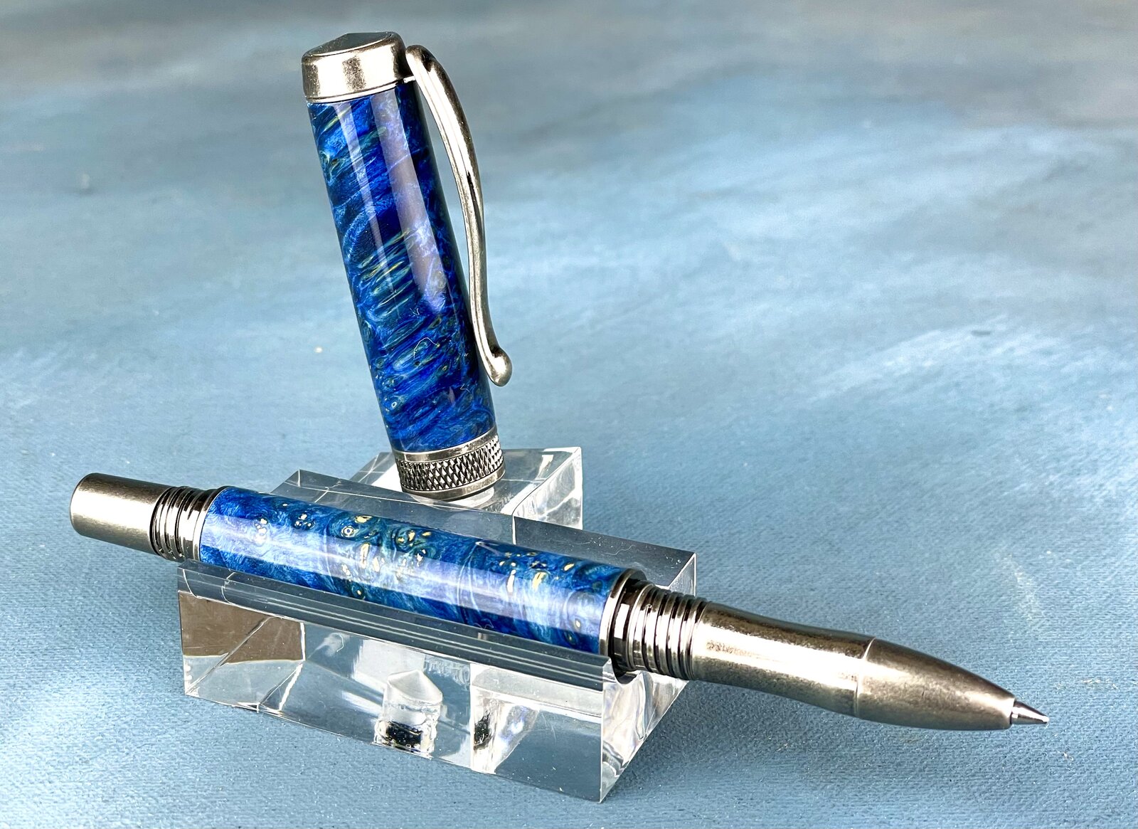

I (and others) use calipers. We measure the nib end, center band, and clip end and write down the numbers and put it beside the lathe. For me, I turn the blank about .005 or .007 smaller than the measurements of the parts. Then I begin the application of CA and build up several layers. By the way, Foam applicators and those parts bags apply a smoother surface flow than paper towel does most of the time. I tend to overbuild and then take my special made scraper and turn to size, measuring every 15 to 20 seconds of turning until it is the size I want on each end.
My pens feel and look like the metal kit matches the turned and finished blank. The feel is very telling if too high. If you can SEE the difference you have an even bigger problem. That said, I turn to the Nikitas TBC bushing, sand carefully with a delrin bushing, clean with alcohol and apply finish. I sand when cured carefully and buff. I use other delrin bushings while buffing to prevent over buffing the blank at the ends. Some may wish to make this more technical than I do. My pens sell fast and repeat customers talk about the difference between mine and other pen makers in my area. Unknowingly they complimented fit and finish.
I hope this helps anyone wishing to have nice pens.
