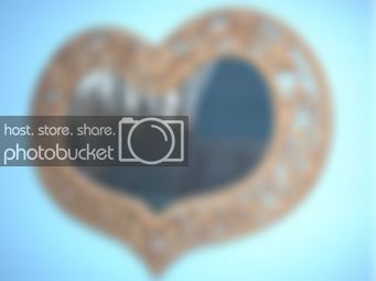

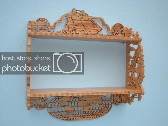

Wow Tony giving up already. That would be a $900 elephant sitting in the corner collecting dust rather than making it. :biggrin:
Maybe you just need some inspiration.
There are a ton of things that can be made. There are many plans out there if you are not into creating your own works. Here are some examples. But as I said with all hobbies there comes a cost. But satisfaction is at your fingertips.

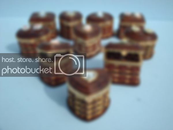

Here is one that combines the 2 hobbies, turning and scrolling. These sell well and i need to get more made some day.
Beautiful, but not my cup of tea to make. I like intarsia, but not the sanding.
