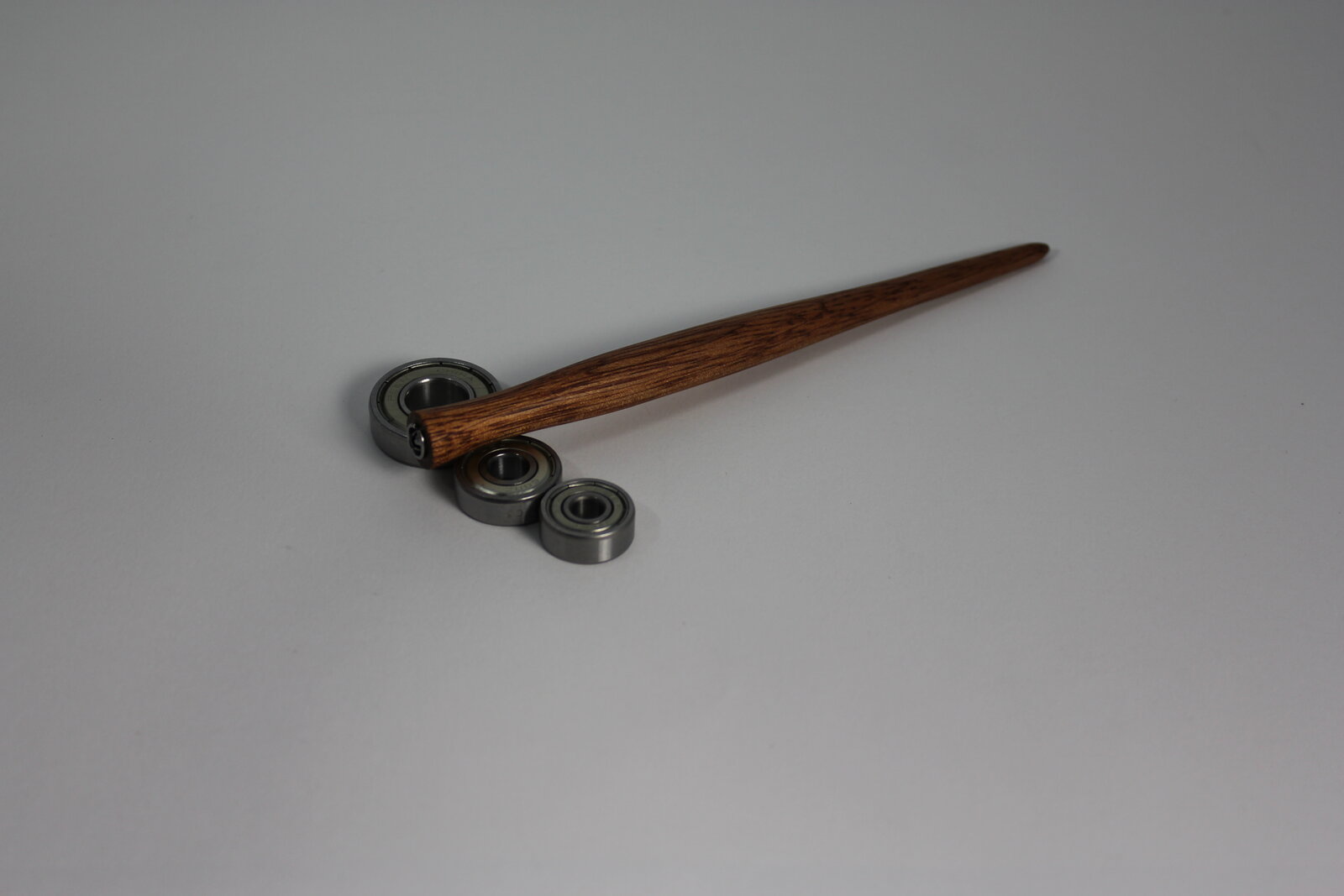

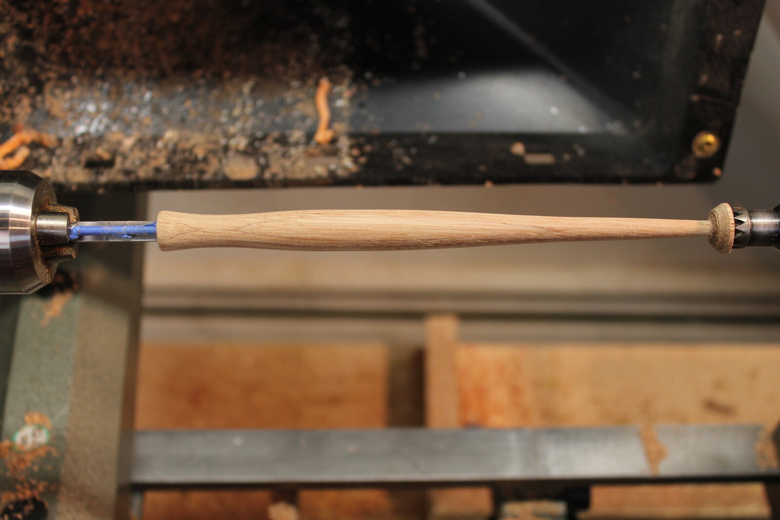

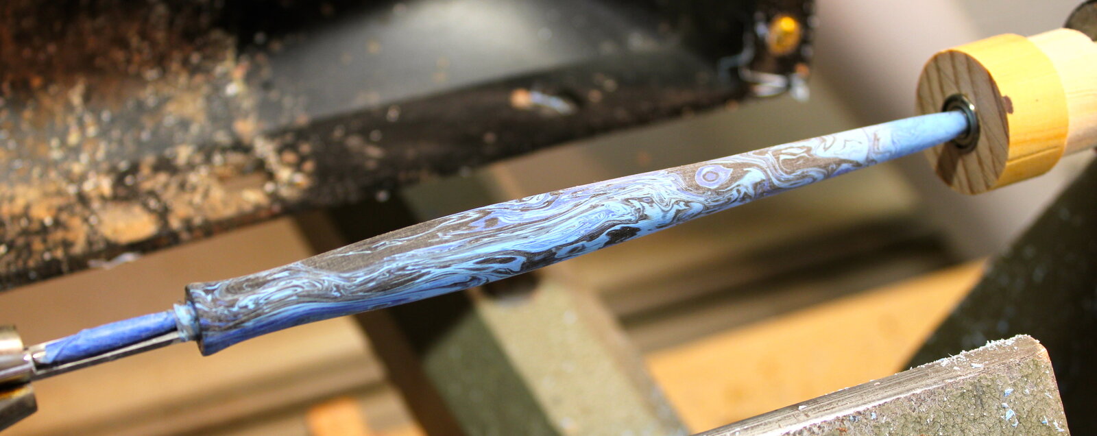

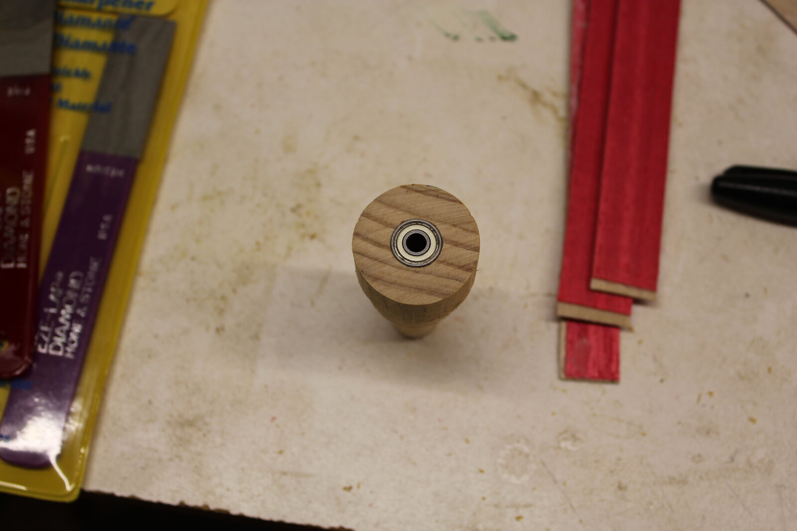

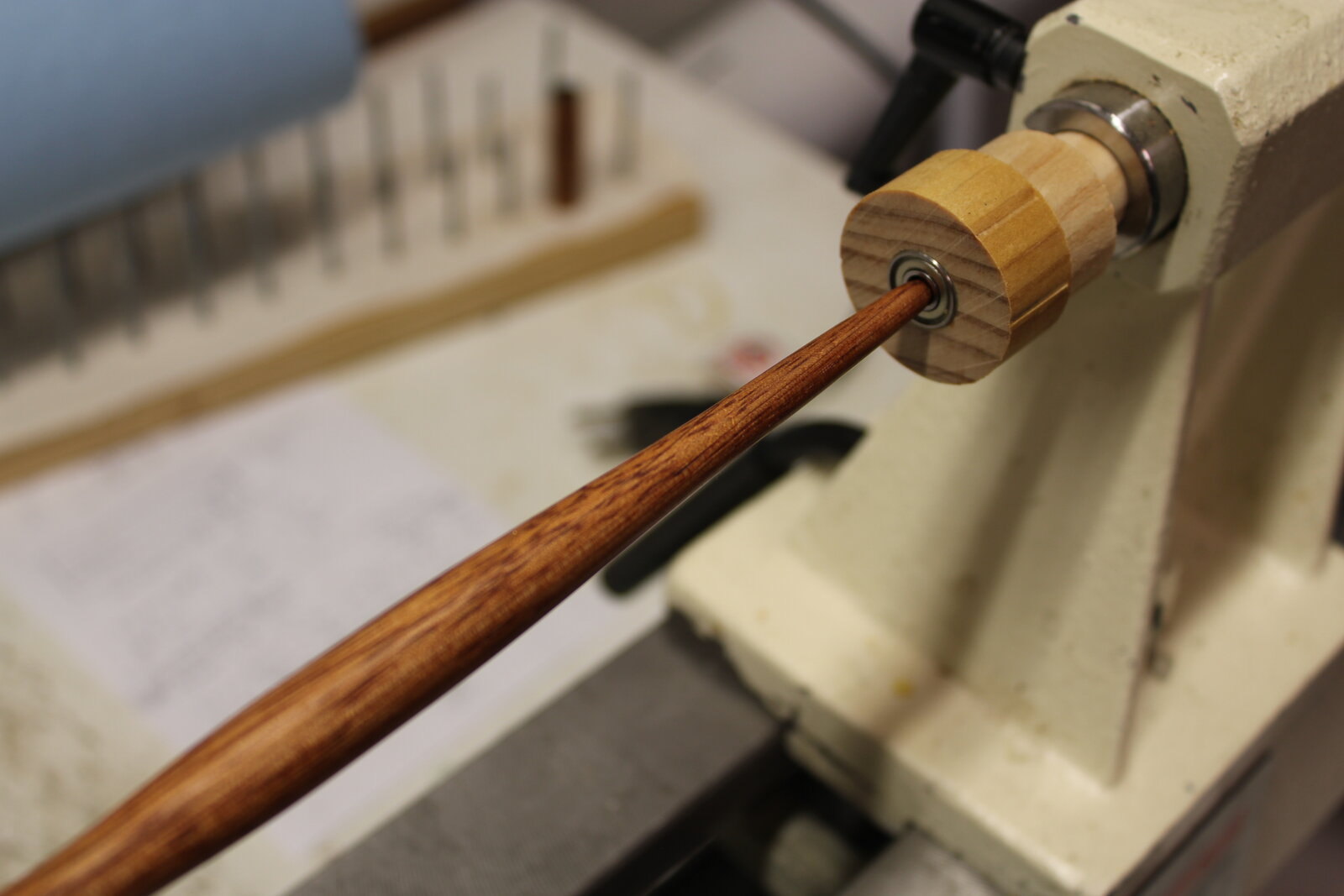

The above comments are all excellent.

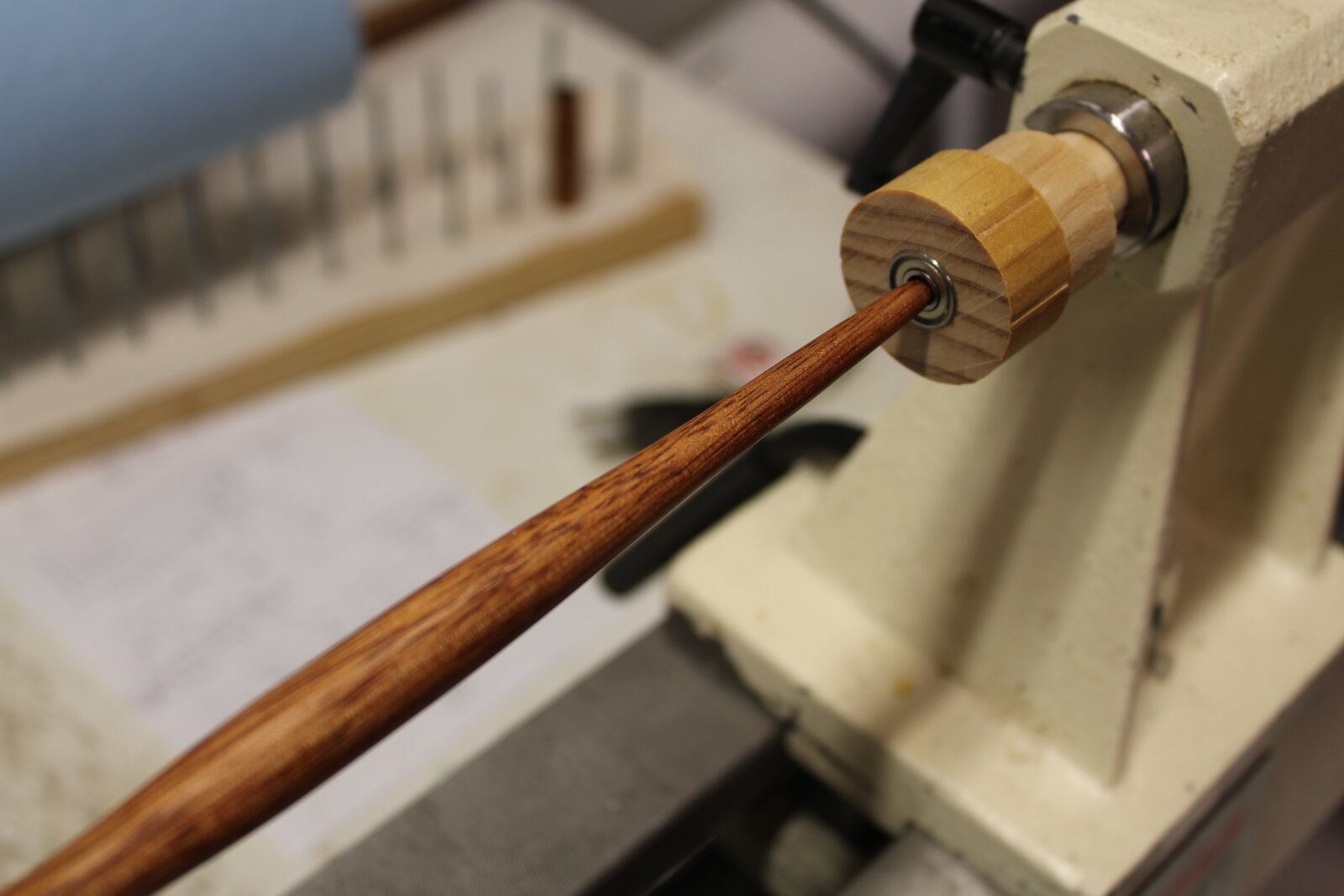

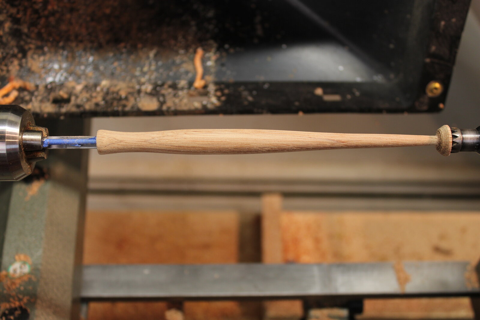

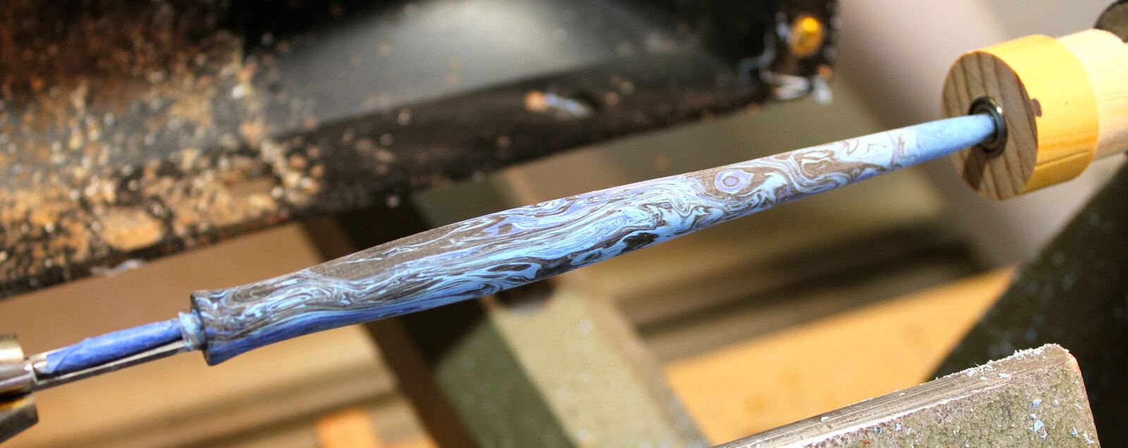

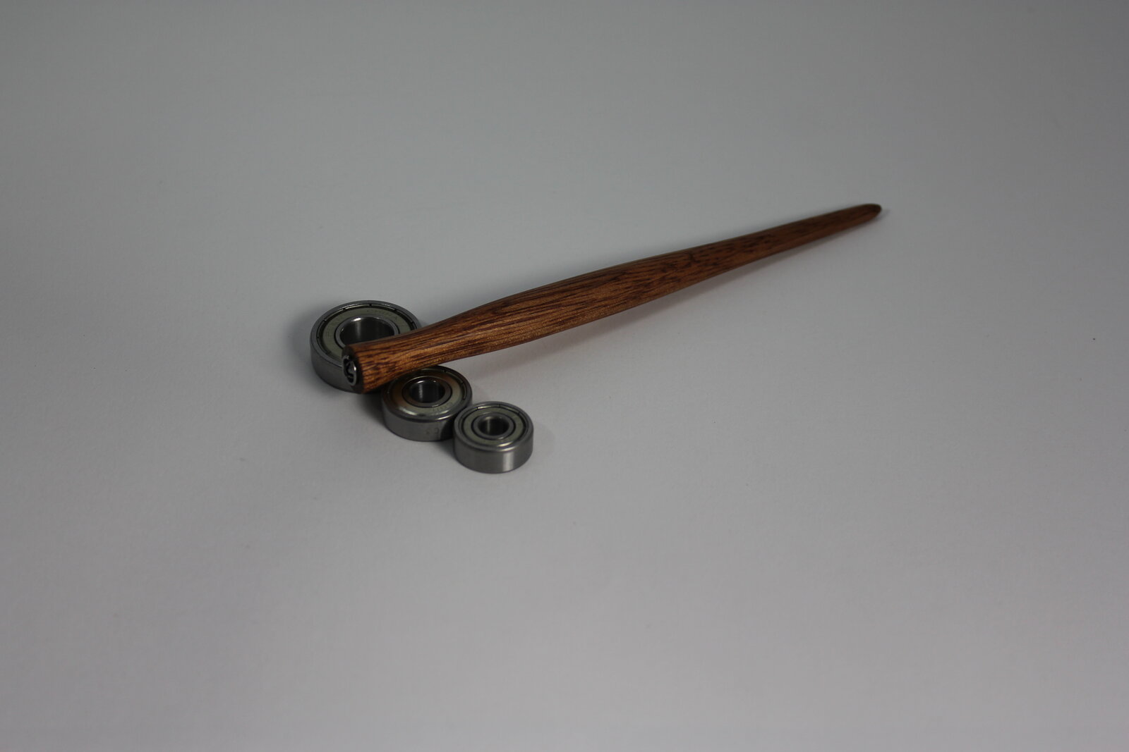

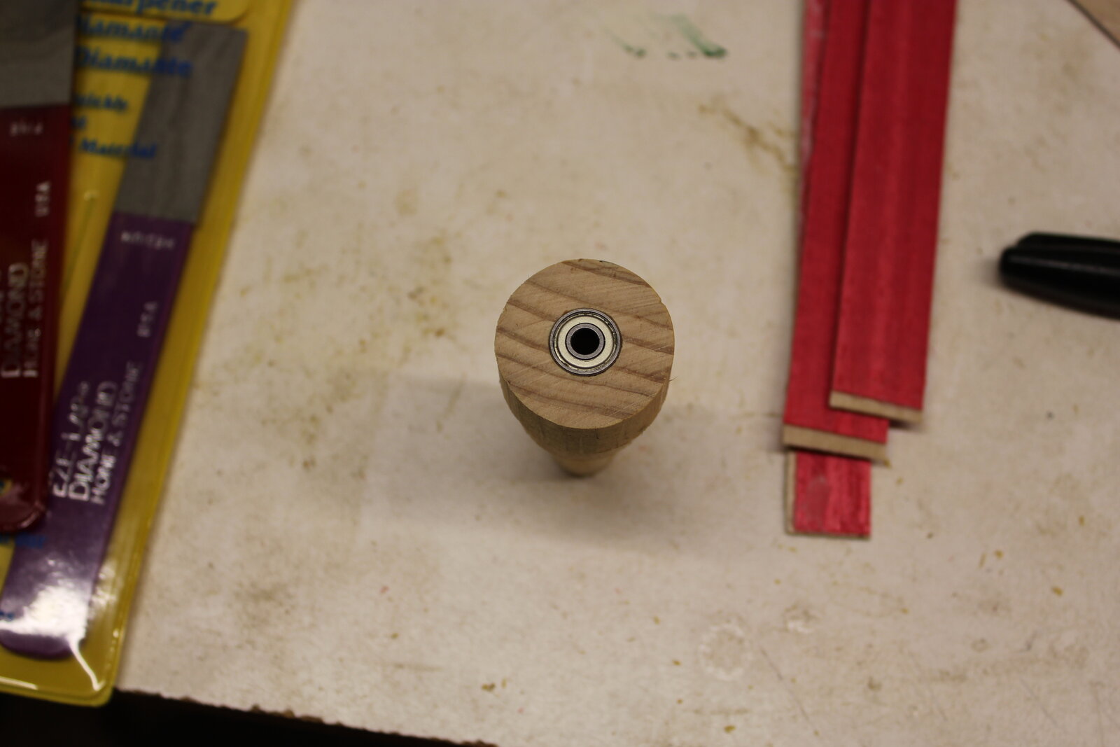

As mentioned above, there are many ways to handle these. I have only turned a few, but this process was helpful for me.
I turned a tailstock insert to accept a ball bearing (Local ace hardware). this allowed me to hold the thin end and finish the turning.
