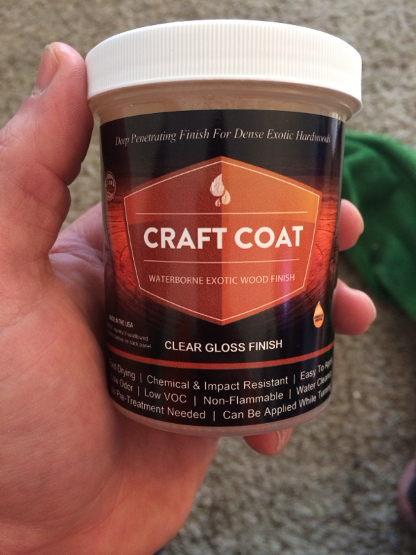

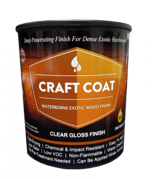

Hi all,
Now that we are into March and the bash is settling down, I would love to see some of your results with CC. To the winners of the CC packages, please give it a shot and post your results when you get some time.
Also, now that we are going to have CC in 6oz and 2oz bottles with some of our favorite venders on IAP, I guess I should post a picture of the new bottles.
