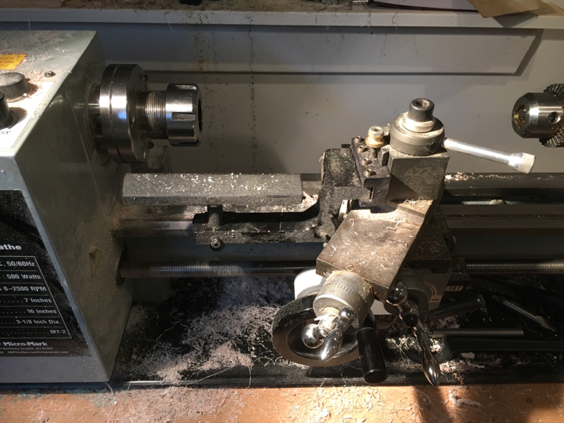

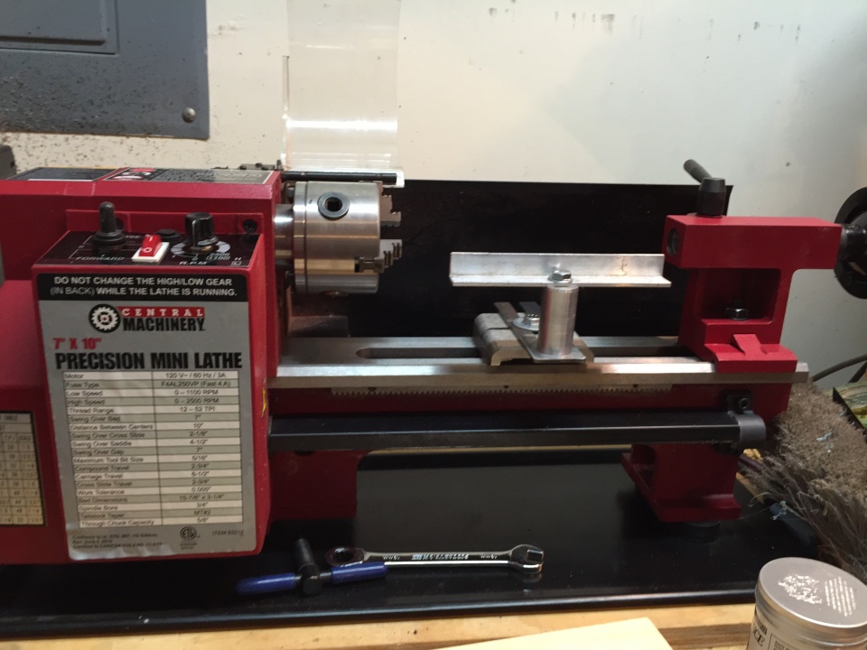

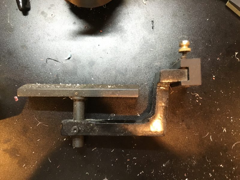

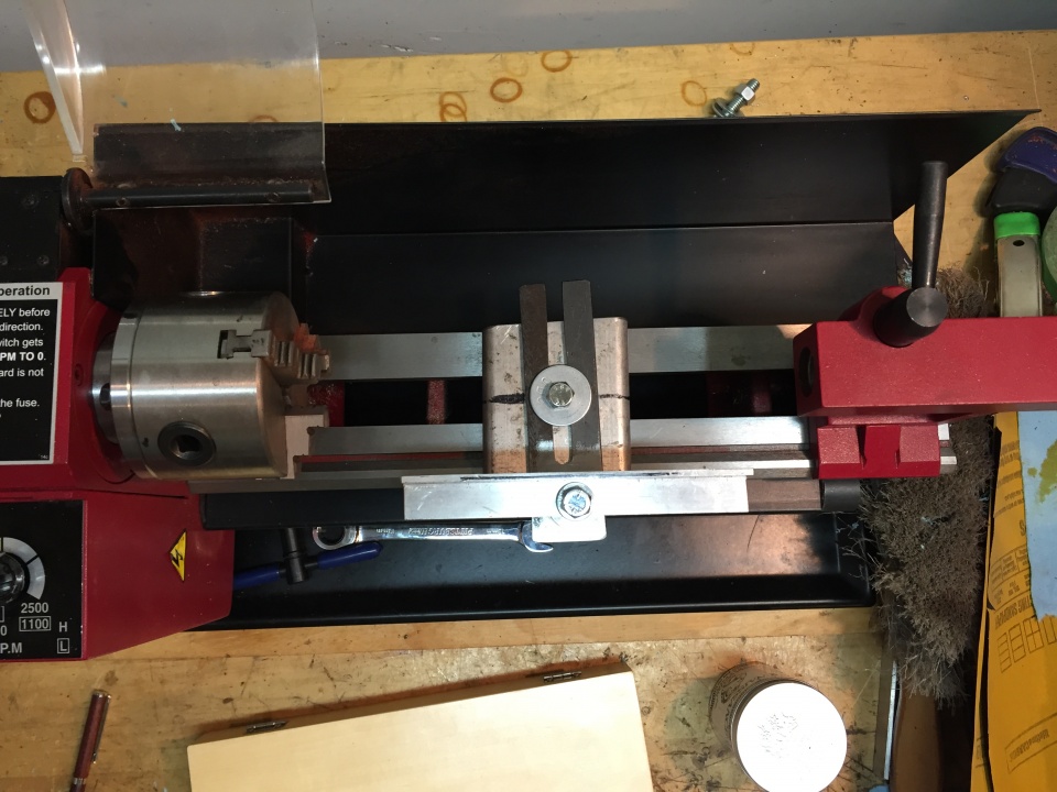

Carl, sorry I meant to post this yesterday.

Here is a simple rest I built for my metal mini lathe.

I didn't do as nice a job as the two preceding examples. I took the boring bar holder for the quick release tool post and put a steel bar in it. It was a quick and dirty solution but good enough for shaping a section or two. Transferring to a wood lathe was better.
