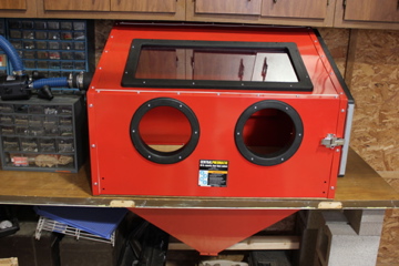

So, the question is not as much as exactly "What it is... although it's not as it seems."
But WHY - EXACTLY WHY, am I modifying this Frankenstein...
The first to guess they WHY will win a few "goodies."
This is not open to all attendees of the last Ohio IAP Chapter meeting and Dan Masshardt as you all have a head start! Sorry.
Should be easy!

Do some cutting and have a dust or chip cover for lathe.
Something to do with working with CA and exhaust fan to pull the fumes out so your eyes don't burn and lungs get messed up.
fume hood:
to pull the fumes away while allowing you to see and manipulate?
pulls PR or CA fumes to your DC?
BINGO!!!
Actually, totally out through the WALL of my garage.
I developed a severe Alumilite reaction (not too common).
But, "Wifey" the chemist said... Give it up! Once sensitized to Urethanes, it will only get worse with repeated exposure (... That means I can't be exposed to...So My project).
This is my last hope!
PM your address and I'll send some Sierra Steampunk Blanks!
Thanks for the FUN!
Can you cast with PR and avoid the reaction or is it the same issue?
Not sure Dan. From what I've read Alumilite was a better option for me with my inherent allergies. I DO think this will work. Nancy (Wifey) will check the system and problem-shoot. She has worked with hoods for 30 yrs, so I've got a "ace."
I won't sweat it if it is not acceptable, but I'm optimistic. All joints are silicone sealed, all hoses go through the garage wall, I have a low volume pump to pull a steady draw of air out, plenty of room to actually do the mixing and pouring under a fully sealed hood.
This may be a decent option even for PR folks who want to avoid the stinky fumes (I've been told) and my pressure pot is fully enclosed.
Cumbersome to be true! But other than selling my new set-up, I'll give it a go!
Let you know how it goes!

Not sure. The fan I'm using has a good low volume draw - not strong enough to pull garbage into the hood, but enough to pull candle smoke clearly out.
I do very little casting. So once or twice a week a few blanks is about it. I can let it vent for a day.
Before this hood system; I casted alumilite 45 PSI, 60 min; let set overnight - solid as a rock.
I don't anticipate anything different, other than the hood/vent system and staying away for 24 hrs. My P Pot hose is extended outside of the garage (I'll post pics) so it will also vent all fumes a full wall away. I expect to purge everything after 1 hr, same as usual, but all will go outside the wall!
Thanks for the Q's - they do help!
I would wonder if you will contaminate the area on the outside where your vent is. Maybe want to steer clear of that area.
Dennis
It will all vent outside of my garage. "Wifey" loves it when I drill 4" hole in the garage walls... Oh yea, she's not home :smile:.
So, my "air-draw" pump will pull low volume air out via a 1 3/8" flex hose directly out the garage wall. The Pressure Pot air hose will be disconnected from the air compressor, connected to a wall connector, and vented also directly out the outside wall. So both "contaminated" air sources that would give me problems will be vented outside my garage - with silicone sealed joints. 16' and 6" wall away!
As they said on the "A-Team" I LOve IT When A Good Plan Comes Together!"
But, My fingers are still crossed!
I understand the idea you have here.
Isn't the rubber seals enough to make it 'air tight'? Do you intend to use the "blast gloves" that it comes with? Are they replaceable? Are you venting out the other side or making the cuts within one of the doors? At winter time.....Is the outside temps going to be a problem?
Would you please show us with photos, the completed setup..........inside and out?
Thank you for this idea.......I haven't your problems but my lungs are already in trouble from years of sandblasting without lung protection. This might just make things easier on so many levels.
I actually took about 15 pics in process, and will take more when fully done and tested. My wife is a Polymer Chemist - so she is a great resource. I'll do a lengthy post with pics in about a week. I'll send you a reminder when its done.
I think although its cumbersome, it may be helpful for those of us that want to do a little casting, but PR or even remote Alumilite allergies (like me), or other respiratory issues... this may be an option.
No problem with reporting what I did and tweaking It!
Thanks for the interest!

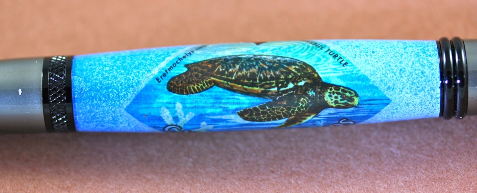

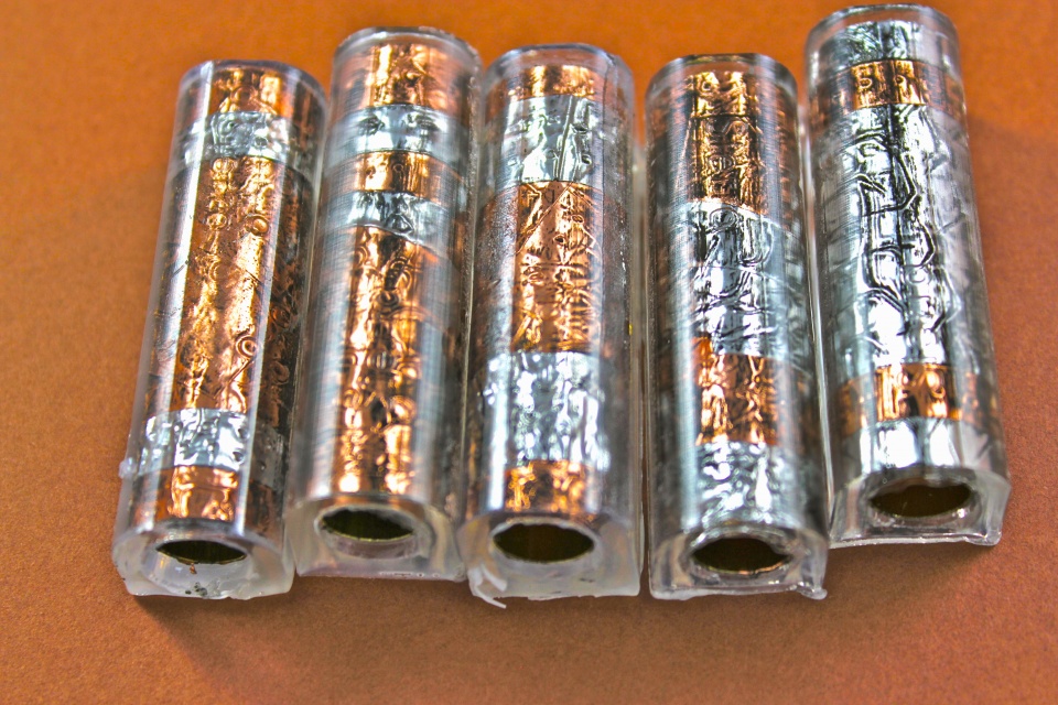

I did about 40 clear alumilite blanks. 30 steampunk style, 10 with stamps. This was for family and friends. I have about 25 relatives that I wanted the stamp pens for their individual interests (the pics in a previous post was for my anniversary).
All clear, no color so it was quick. Of all the casts, only one was with a few bubbles, so technique was fine.
However, my face blew up like a balloon, my arms were covered in a rash for almost 5 weeks! 3 weeks of prednisone. My wife has worked with this stuff for years, monthly OSHA safety meetings, etc... She picked up on it immediately and is not optimistic. The hood may work though.
Hi Wayne:
1. Rubber seals/gaskets: Maybe for sand and small particulates (for you),
but my issue is fumes/gasses, so I went with tons of silicone caulking.
2. Gloves: Wifey the Chemist liked them, but again - for particulates and
may be gas permeable, so not for me. Yes, I believe others will fit.
3. I am using a mid-grade air mattress battery pump which had a GREAT
continous air draw. Not enough to suck in dust from the outside port,
but enough to blow a candle flame sidewise. I didn't want a "shop-vac"
type strength.
4. I disconect the hose from the air compressor, attach it to the wall junction, and
vent the pressure pot directly through the garage wall; same with the
battery pump for the fumes in the box itself.
Hope this helps.

Hi Mark, as long as you have negative pressure, gas permeability shouldn't be a problem. Any leaking should be from the room into the chamber.
Joe
Joe
Yup! That's my thought all along.
I've ordered better gloves: Atlas #772. Nitrile coated. It is good for 260 chemicals and fumes! Resident Geek OK'd them before leaving for England this AM.
