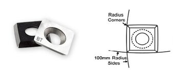

Based on the large number of carbide insert tool users I thought I would put together the following group buy. The inserts will be bought from Global Tooling.
attachment.php
The group buy is for 15mm x 15mm x 2.5mm carbide inserts with a 100mm [4"] radius; the corners of the inserts also have a small radius (as shown in the picture). These inserts are the ones used on the "Byrd" Shelix Journal (Helical) heads found in woodworking planners and jointers.

Will these work with the Woodchuck Pen Pro?
These use a standard M6 tapered/countersunk fastener.
FYI this is the standard faster for the insert that General sells. Note that it is too long for a lathe tool. http://globaltooling.bizhosting.com/products/knives-ick/spiral-head-knife-spare-screw.html
I am 90% sure these are the exact same insert that are or were sold with the Pen Pro, I cannot confirm this though as I don't own one; I made my own.
FYI this is the standard faster for the insert that General sells. Note that it is too long for a lathe tool. Spare Screws for Spiral Head Insert Knife - Global Tooling
Do you know what the Pen Pro uses?
AK
Glad you only were 90% sure, you get to keep,10%,which is about what the inserts are worth.
The inserts the Woodchuck Pen Pro uses are made in Germany by Tigra , and are alloyed to cut hard woods, The inserts from Global are made in China and are primarily made for cutting MDF and wafer board, the grain structure is larger.
The sharpening which on the Tigra is done radially, while the Chinese is done from top to bottom. If you compare the two you'll find you are getting what you pay for.
The Tigra inserts are quite a bit better, both in sharpness and in durability, BUT they do use the same screw, and since you're buying the cheap inserts why bother with the Stainless screws. Also the Woodchuck inserts can be honed easier and sharper once dulled since the sharpening from the factory is done radially around the insert rather than up and down along the cutting edge.
All carbide is not created equal, When we first started making the Woodchucks we did use the 14mm from Global and it worked OK, then we tried their 15mm by 100.mm radius insert and it was OK but when we started looking for a 50 mm radius we were contacted by a bit 20 or 30 Chinese manufacturers, and by Tigra, their prices nearly floored me, but after arranging to have the mold made for the 50mm we bought 1000 of the 100 mm done from the same carbide and noticed a difference right away, , By the way why not skip Global entirely and go to their supplier TY Carbide in China, Yup we even tried them, same stuff, but it won't hold up as well as ours or Easy Wood Tools, inserts,

I stated "are or were" used in the Pen Pro, thanks for confirming they were.
Also, where is your information coming from on the use of these inserts?
...The inserts from Global are made in China and are primarily made for cutting MDF and wafer board, the grain structure is larger.
These inserts are designed for the Byrd heads used in planners and jointers to plane highly figured wood. You don't use these machine for the materials you claim.
Thanks for the derail, hope you sell lots of $7 inserts.

Andrew I wasn't derailing you, You PM'd me last night about the screw size, I answered you and thought I'd check it out, but you said you didn;t know, and were 90% sure we used the same inserts, just correcting some misinformation, Sorry if you feel I was stepping on your toes.
Three years ago I did a direct deal with the company that Global gets theirs from, TY Carbide in China, talk about a deal from hell.
Global is a decent outfit, your best deal is on their 14 mm inserts we used to sell a lot of those when we made the first tool, and while those15mm x 100mm radius inserts are made to fit in to a Byrd Shelix Planer head, they won't give as good of a finish for very long, but you're saving 4.00 an insert so if it takes 2 or 3 to do the same amount then what the heck it's a push
But if I thought the Global inserts were as good as Tigras, I wouldn't be spending 375.00 a hundred for the 100 mm radius inserts,with a 500 MOQ.
Check the ISO standard for the Global inserts, see what the rating is and what the composition is, the ISO will give you the composition and the grain size, you're looking for Nano Grain. Like I said, they'll work, BUT you're going to get what you pay for.
And the Global inserts have never been used in The Pen Pros, Only in the first hundred or so Woodchuck Model A which was our first tool with a radiused insert, we quit making them about 3 or so years ago at that time the tool was 34.95, and the inserts were 3.75, but they weren't made out of Stainless with a Stainless screw either, which at some point you'll find the reason for.
If you think we are gouging look what Global charges for their 11mm back knife cuter, we only make a couple dollars from each insert. so hey what ever you want to think. Think it. We have brought only top quality tools and inserts to our customers, and we've stood behind our products, are YOU going to stand behind the quality of this buy?
