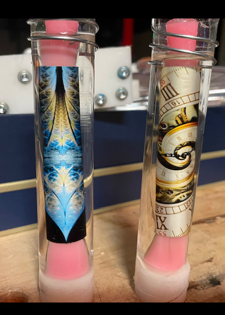

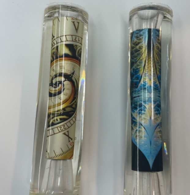

I am working through my process for clear casting blanks. Spent the last 2 weeks figuring out label types and methods of printing, cutting and sizing. I will probably pass on Silmar because of the reported smell. People seem to like Al. Clear Slow but even the smallest amount is 2x16 oz bottles which always goes bad before I get close to using all of it. Is the Alumilite Amazing Clearcast an alternative? It comes in 8oz bottles at Michaels.

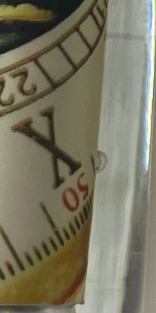

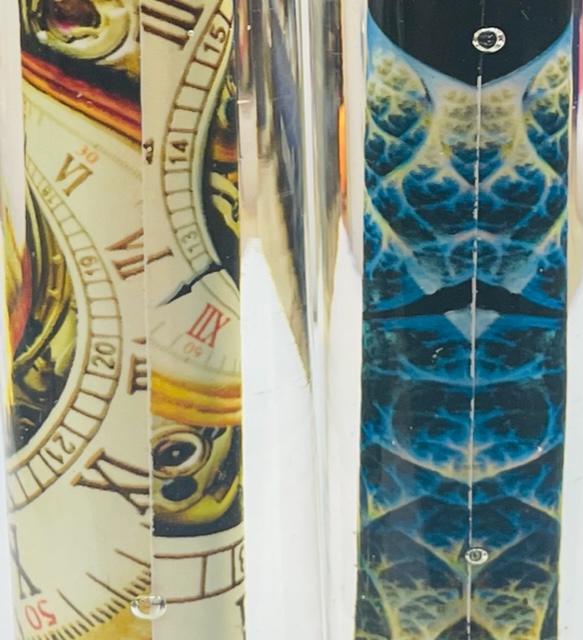

Just came across this thread. I just started trying label casting. As always there is a lot to learn! I am using Alumilite Clear and Slow. For labels I am using Avery waterproof and printing with a black and white laser printer. I have also tried epoxy. So far I have to say my experience has been very mixed! I got a half decent result with epoxy but my first Alumilite batch was not great. The only part that appeared cloudy was on the top of the blank (no doubt moisture from the compressor). When I turned one, all looked Ok until I got near the end and saw what looks like a small cloudy area nearer the tube. I have a few questions: what labels do people use and how are they printed? When I looked at other blanks it appeared as if the join in the label has lifted. Is it worth sealing the label before casting? What is the best approach to eliminate moisture?

Cloudy or milky color with Alumilite clear or clear slow is either (1) incorrect ratio of the two parts or (2) incomplete mixing of the two parts. Moisture causes foaming.

I thought moisture could cause a cloudy appearance. I didn't notice any foaming, so the cloudy appearance must be from another cause. I carefully weigh parts A and B, and thoroughly mix for about 10 mins, making sure to scrape the sides and bottom of the container. The mixture was completely clear before pouring. So, not sure what I am doing wrong.
