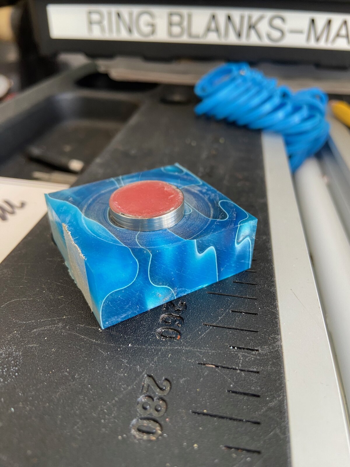

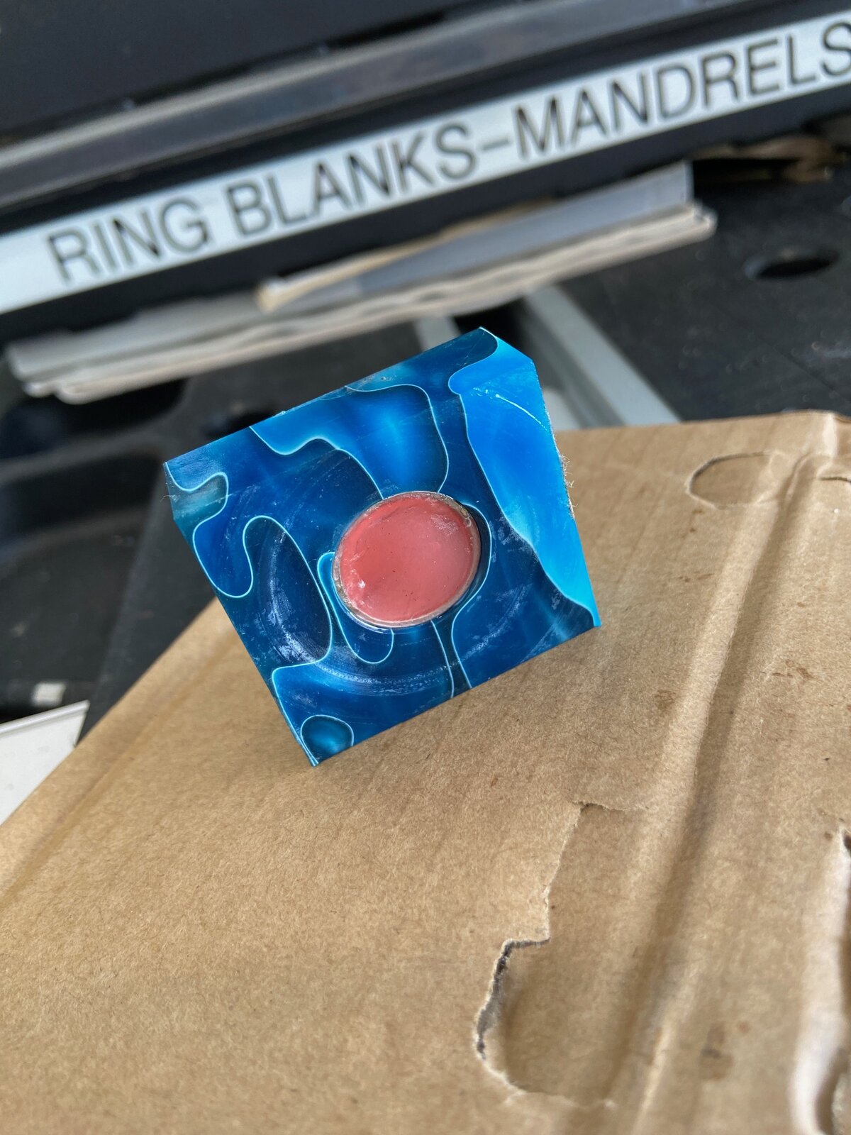

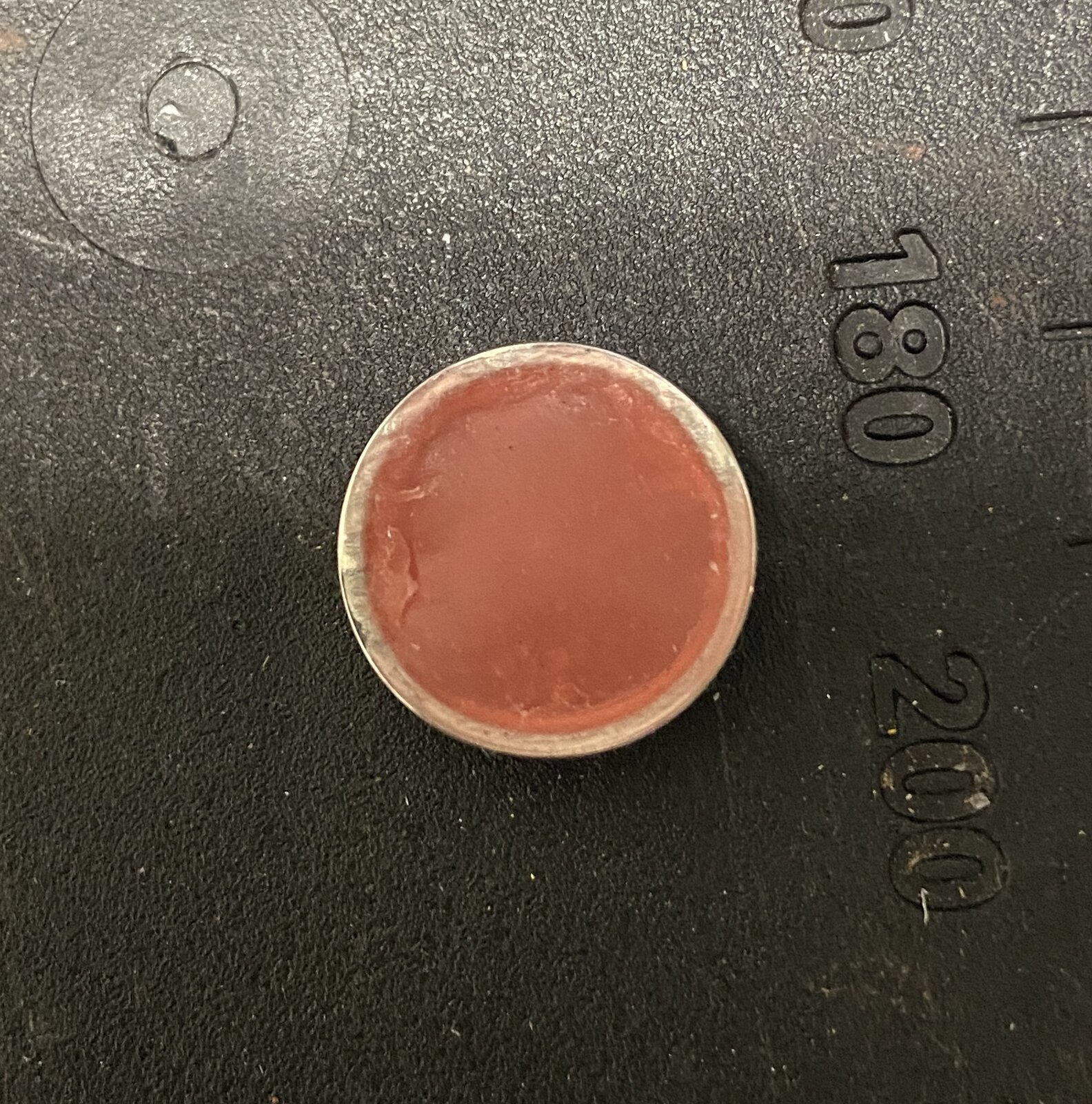

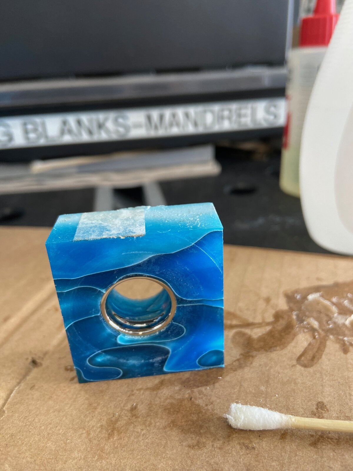

It takes (me) more time to clean the glue from the core center than turn and finish the ring. . Enough is enough. Base plate wax YES!

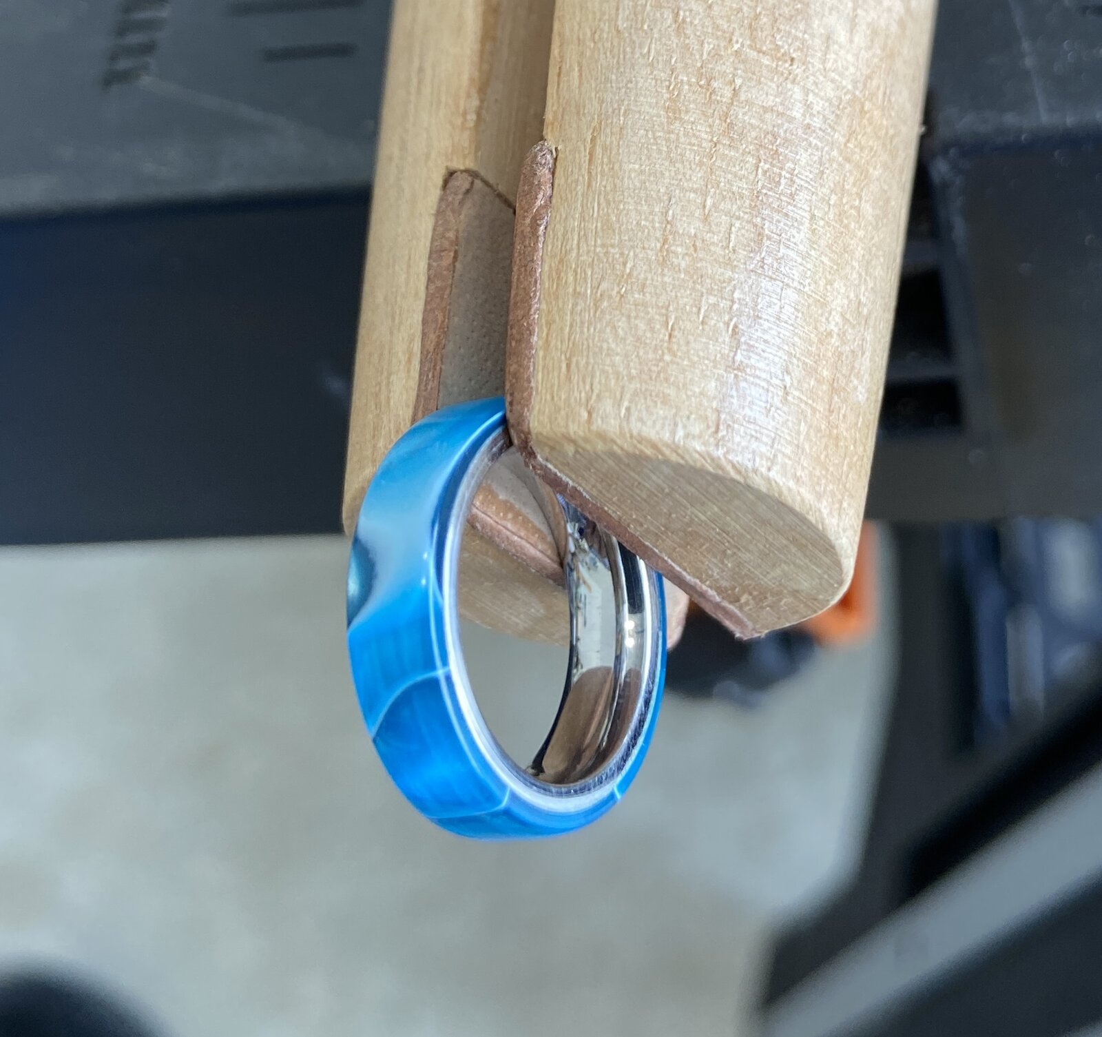

I made another today. Had to do 2x and do not like the way it came out. I HATE RINGS.... may all of them distort. I should say I hate translucent blanks

So… made a Ring 2x. First one bombed. 2nd turned ok but not perfect and it did not fit right. Was loose on the receivers finger. I hate these things. I'm considering giving the ring components to my cousin. I'm not giving up. I'm simply quitting.
