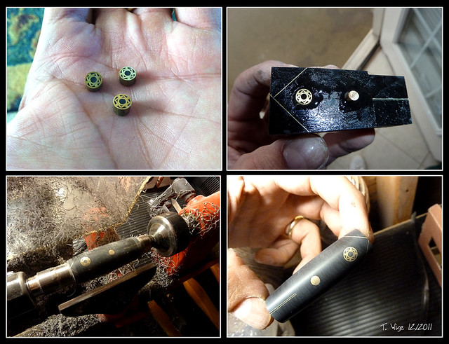

Okay, so after going through the library I came across a video tutorial done by Ed Davidson about adding "Gizmo's" to the end of your pen. I followed the link provided to the vendor to buy some, but they no longer carried them. Jon Piper was kind enough to send me his last 3 to do some tests with. What you see in the images is a result of a couple hours in the shop. See write-up under images for details!
The wood Mosaic test is done on a full sized Statesman lower barrel. The wood is Birdseye Maple, the segmenting is a Brass, Styrene, Brass sandwich with a black PR band from Dawn. This has been turned, but IS NOT finished. I still have to put a CA finish on it. Waiting on my CA to arrive in the mail...just have thick left.
The Black Mosaic test is done with PR from Dawn on a full sized Majestic lower barrel. I did a half scallop on the top with the mosaic in the fold. I added a brass plug below that for effect and did a verticle segment under that with the same brass, styrene, brass sandwich. Not sure it needed that, but it's a test so who really cares.
NOTES: The wood held up and I wasn't as scared that the mosaic pin would rip out. I think the wood acted as a buffer a bit. The PR was VERY slow going. I felt that the blank would blow at any second, but I took REALLY slow cuts and just skimmed the surface until I had it shaped. The possibilities are endless with this, but just like scalloping...it's a real pain in the butt!!!!:mad:
Hope this helps others

I love it personally... That black one is a seriously nice look that I would be more than proud to have as one of my pens. I like it a lot, and the brass line down the bottom was more than necessary in my opinion, otherwise it would have been off balance. Great job, I really like that look. Now we just need to find a good supplier of those!

You can find them on knife making sites. Seems that they use them as accents as well. If fact I'm sure that's where the idea started and it was just adopted by pen turners. It's been around for a couple years, not sure why it never took off...:confused:

Well Tim, make it happen! I am sure if you did something similar to the black pr blank and did a top and bottom, put it on one of your majestics, you could easily start a motion. That would be cool to start seeing in pens, especially custom finials and such. I hope to try that sometime as well

Isn't that the truth. Hopefully sometime when I have some time I can experiment with those also. They kind of look like sundials

Yeah, they come in all different patterns and are pretty easy to make based on the tutorial, but I think I'll just pay for the pre-made ones.

Looks great now that it's turned! I also really like the brass line on the lower half of the blank.
It grows on you. When you hear segmenting you wouldn't think of an accent that leads into nothing. Just directing attention I guess. Thanks Jonathon.

Loving the black one! I think the vertical scallop makes it look like a knife. On the bottom left picture the inside of the brass tube has the illusion of being part of the outside, and I think if there was a brass ring at the end of the scallops at that point it would really work.
