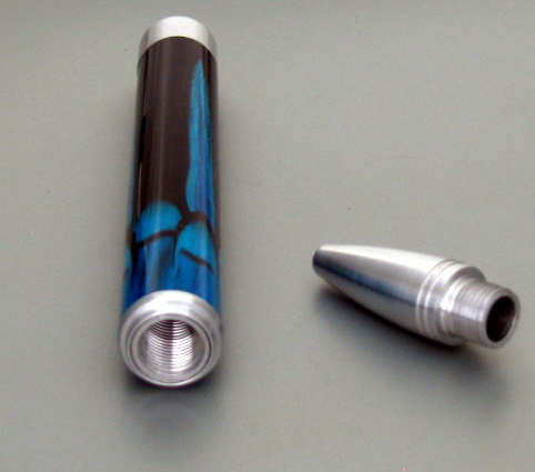

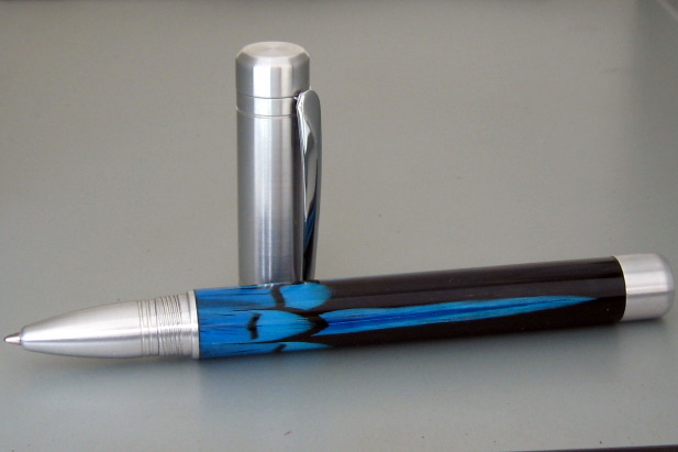

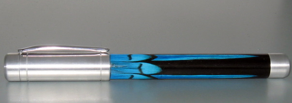

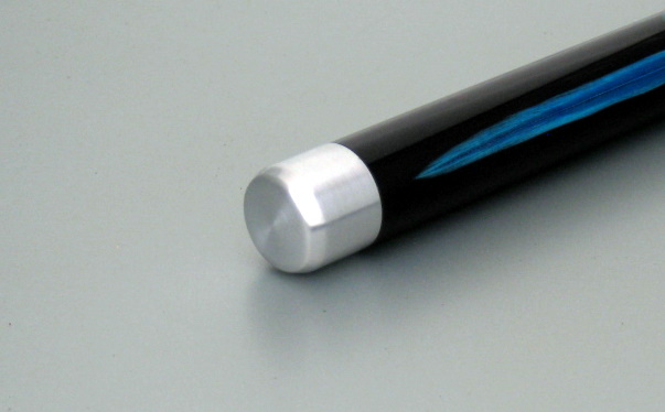

When I first saw this Zen blank made by Marla, on IPD, I thought....that might make a nice kitless pen or, close to kitless. I wanted to use ALL of the length of the blanks length so, I just squared the ends enough to BE square and left the excess PR hanging over the ends of the brass tubes. I wanted to put the nib on the black end. After turning the blank to size, I then started to cut threads for the cap with the 12mm triple start die. It broke off a piece of the barrel. So, I made a cap to cover it. On the opposite end, I made an adaptor which I threaded for nib. So, I ended up with a pen but, no way to put a cap on it. After awhile, I called Mike Roux who offered a suggestion. His idea was great which involved drilling out the threaded adaptor and fabricate one that had both threads on it. I didn't want to risk destroying the blank while drilling so, I decided to make a sleeve and glue it in. The two photos with the nib off are before and after showing the adaptor. This was going to be a contest entry in the beginning. But, it was still fun making it. I am so glad I bought this metal lathe. Thanks for looking!
I forgot to mention that I had no bushings for a Zen kit so, I made some.

Absolutely unreal. Chuck do you have any idea how much your skill has advanced since leaving Indiana? Looks like all that sunshine is doing you good. Of course it does help being near Mike & Mike.
As for the pen, it is awesome. Your cap looks professionally done. Which clip is that? I know it is not aluminum but it goes well with the aluminum. I think you did good enough that you can kick back and watch the race today. Congrats on a great save and a beautiful pen.
