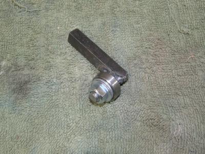

I really liked this tool idea but lack the welding skills or availability other than taking to some local welding shop. After looking at it a bit I realized I could accomplish the same thing without welding so here is the poor mans alignment tool!.......
This shot shows a square piece of stock, in this case my Dremel tool holder, which I drilled a hole in the end and used a bolt to attach an old band saw bearing. It actually works GREAT!
Here's another view showing how simple the tool was to make for those "welding challenged" like me. Pay no mind to the back end of the tool, any square stock would do, this was just handy.

What is scary is when you are needing to hire a guy who says he has 20 years of experience, and he comes into the shop to make a test piece, and this is how he goes about centering up his tool. Then has to ask fo rhelp when it doesn't cut right. This will work for a lot of things. best results are the tool at or a hair below center. After you set the tool this way, take a face pass on something down to close to center, and see where the tool is compared to the little 'tit' that is left for final adjustment. WARNING, if you tool tip is too low and you face off passed center (in metal) you will very likely break off the tip of the tool.

Paul, Thanks for the insight.
This may be too "general" of a question to answer but....... Is there a way to tell by the material coming off or the resultant surface look and/or feel if the cutter is set at the proper height using the a bit with the right angle?

I'm sure there is, but if the tool is too high as the part gets smaller, it will seem like the machine is working harder to cut, because it will start to rub the material below the cutting tip rather than cut. The finish will likely be a bit 'record player'-ish if too low.

Bingo.......... the 33 1/3rpm phonograph record is my typical finish(sometimes a 78 rpm), looks like I'm too low then, I'll try raising the bit a bit!
