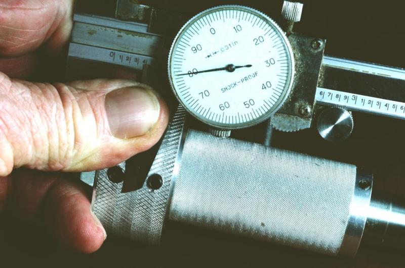

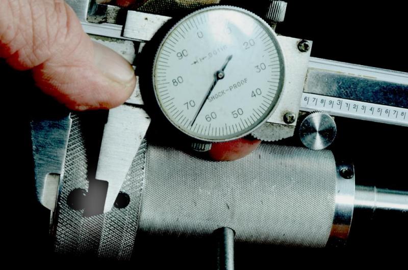

Johnny: This is probably not an issue to you, but as I muddled through the adapter that I turned, on my old South Bend, for my SIL and I, I found that Tapco was about 15 or 20 .000 ths off on the spacing of the two dimples they have drilled in the outside diameter of the die. To get the die to lay flat, I had to take separate measurements, and then with my "non-machinist" abilities, or lack thereof,:redface: I have to leave my set screws a little loose. At least the die doesn't spin around inside the adapter, so gimme a break!!!:biggrin::biggrin: I consider this a flaw in their machining, and I would not be surprised if there were different variances in different dies. JFI and Just a speculation!! see attachments below
