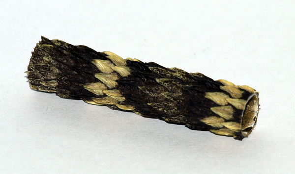

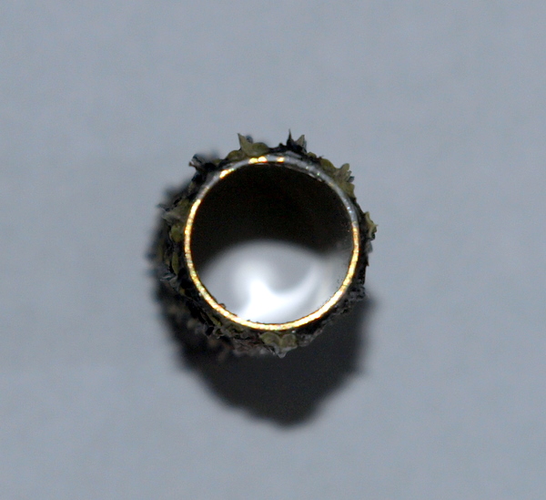

I have 2 Eastern Diamondback rattlesnake skins that I want to cast but have ran into a problem. The scales all have a ridge in the middle that runs parallel the length of the scale. I have tried one sierra but after gluing the skin to the tube all of these ridges stick up higher than the smallest finished part of the pen. Meaning if I were to cast the skin it will stick out of the blank, after finishing, on each end.
Did the skin just not get stretched enough while tanning? Is there some way of removing these without ruining the skin? Any help would be appreciated.

You can see in the pics that the ridges are looking a little too high for the finished size.

If you will wipe a lite layer of CA over the top of that skin(wiping in the direction with the scales) they will lay down better, but be sure to let that cure for at least 2 days so the CA will have time to "outgas".
The skin is on a Sierra tube. The two snakes I have were over 4' which is not real big but bigger than any snakes I have skinned at this point.

PERFECT, that was the info i was looking for, so there is a possibility that the size of the scales are a bit too big for that type of application. What i would recommend is to either use a sierra vista kit which will allow more room, or try the CA method I mentioned earlier.
Bigger is not necessarily better when it comes to rattlesnake skins and casting pen blanks. Bigger snake = bigger scales = your problem. Some rattlesnake species have much thicker skin and scales than others. While eastern and western diamond backs are really pretty they can get too big for using on pen blanks....or, at least I think so. Good luck with your casting.
