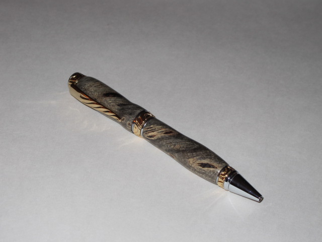

I do the same process but as soon as i begin to turn i wet th surface with padding lacquer( behlin qualasole) rewet between gouge cuts and between sand grits. When i am finidhed i have a lacquer stablized buckeye burl.
