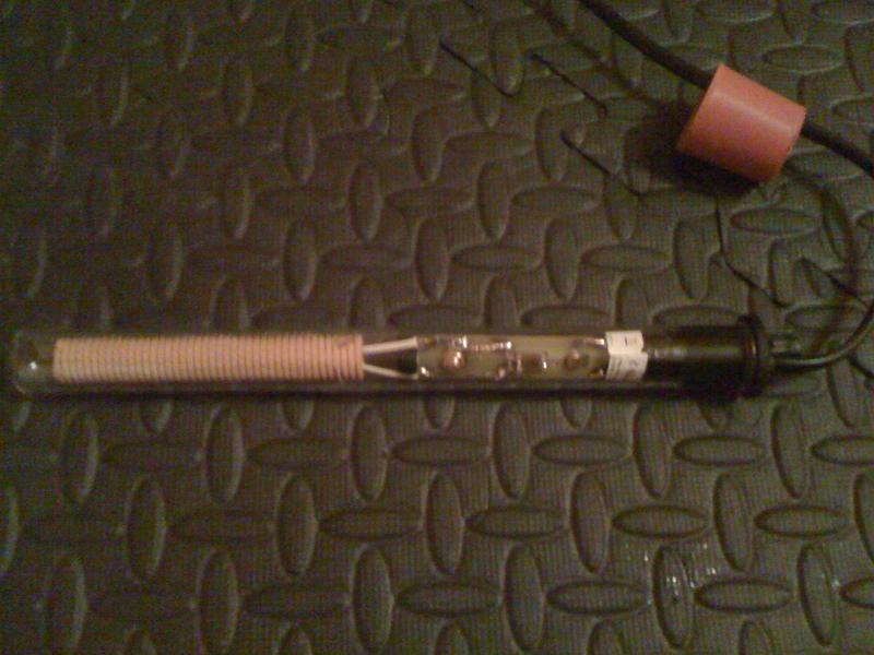

The other picture is an experiment i am toying with. i found a company which supply Aquatic/homebrew immersion heaters which usually have a temperature range of up to 35C, whereas i need up to 60'C. They are able to adjust the temperature range to cater for what i need so i have ordered one to see how i get on with it in the dye tanks. if it heats it up quick enough and maintains a constant temperature it will be a winner as i will be avoiding using the cooker (keeping the Mrs happy - well, apart from the sealing process any how :biggrin: but at least thats just water)
